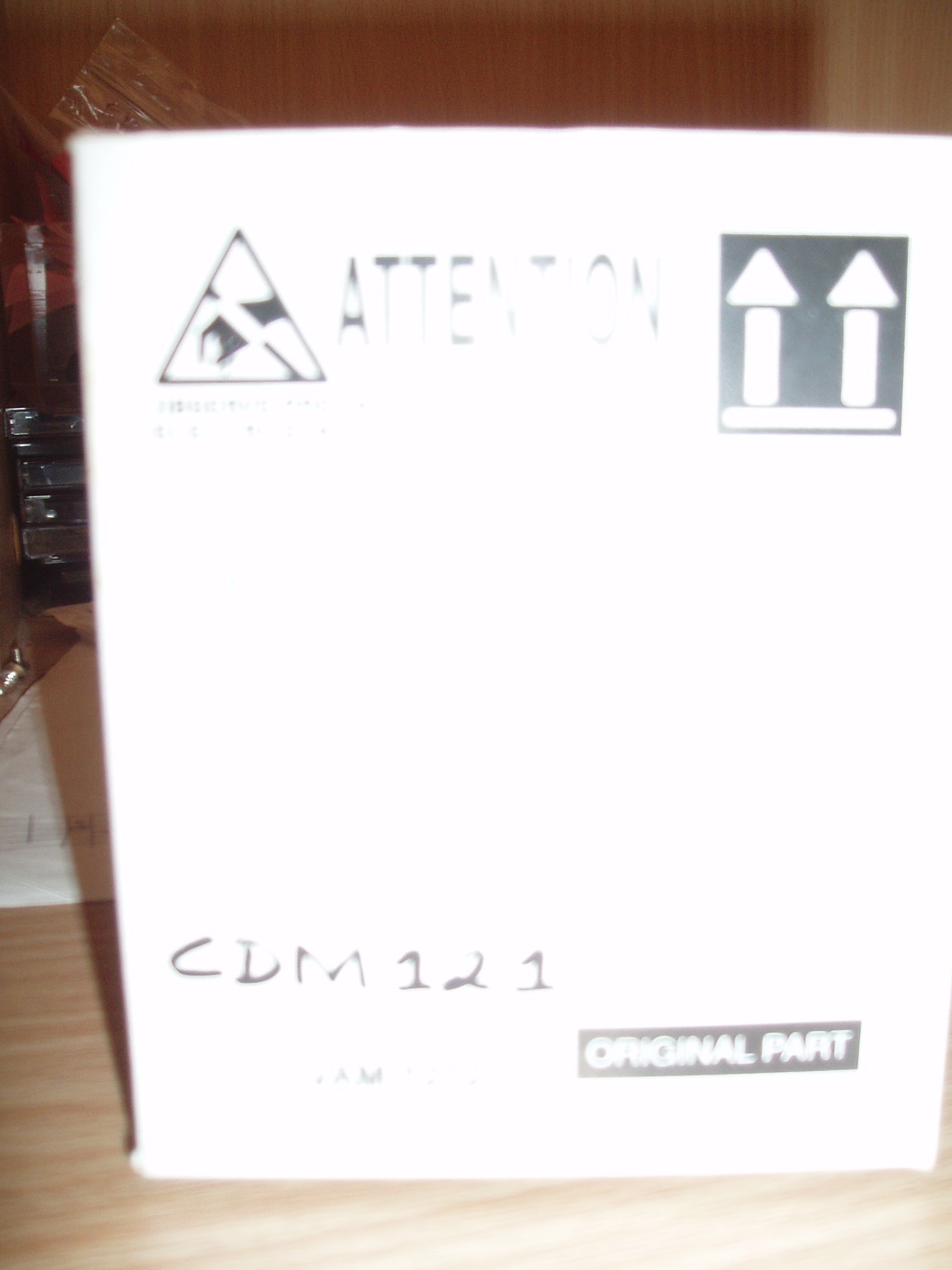

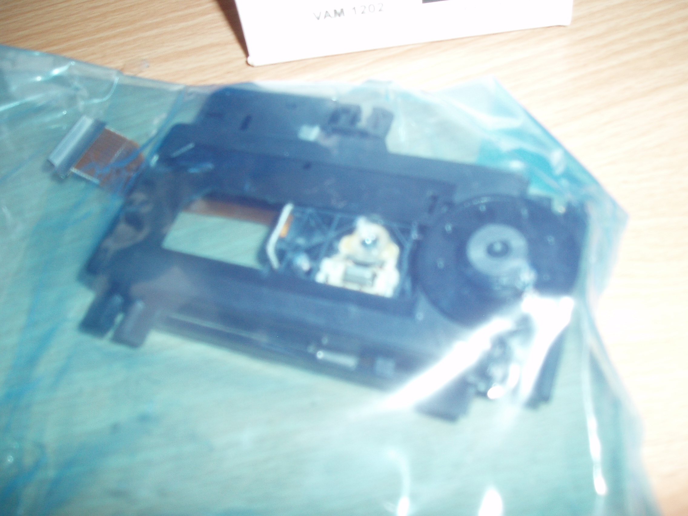

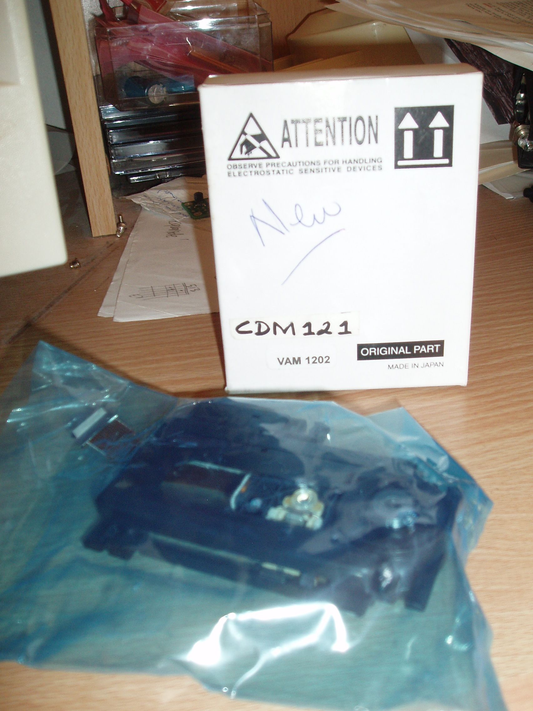

The laser pickup was supplied in a white cardboard box with:
'VAM1202 ORIGINAL PART Made in Japan' printed on the package.
There was a sticker attached to it which also said: CDM12.1
Additional information included warning about electrostatic sensitive devices. Pics to follow.

You can be in this case reasonably certain that an orig. Sharp Hologram laser diode is inside, even if you read "Made in Malaysia", "Made in Singapore" or "Made in Taiwan" show". If you read "Made in China" which unfortunately is usually only a replica of the Sharp hologram Laser diode, that have poor quality.
Please note, there are one difference regarded VAM1201, VAM1202 and CDM12.1 - as I know: this is the magnet strong of the magnet, that is inside in the motor pulley (turntable). Optical pick up is the same by all this types.
I use optical pick ups of the CDM12.4, but this one I get currently unfortunately only with "Made in China"
