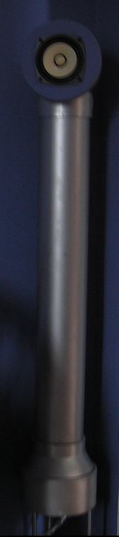

It is not that I am fixated on PVC or that there is some priapic preoccupation potentiating these proposals (say that 5x's in a row). I just happen to have a bunch left over from an outdoor project gone awry.
When I look at unfolded TL cabinets, or designs like the Zigmahornets or the Vampyr I can easily see building these inside a PVC tube. With vey little trouble I could whip up the endcaps and the minimal internals of these designs.
Clearly, length and placement of the driver, and the size of the vents are critical. But what of the shape. From my lay perspective there are going to be advantages and disadvantages to a rectangle versus a round pipe - all issues of mechanical resonance, zero'd out, what is the difference between the two designs.
If the Vampyr is essentially a 5.5x6.5 inch rectangle tube, what would the difference be in a 6" PVC tube?
If there were something critical about a rectangular versus a cylinder I would respect this and build the rectangular tube. I just don't know enough to think through this in an informed manner.

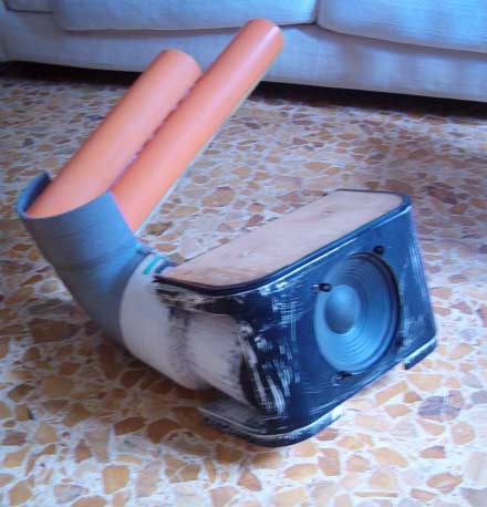

They work fine! At the end of the design ,listening to it , you will hear a different kind of resonance , the one (s) produced at low frequencies ,depending on the thickness of the plastic , so it is better to damp and bitumen cover all the internals.
But I like the "light" distortions of it , after all the finished speakers will weight a lot less as if they're of MDF , or you can mix the two materials , linear vs. circular shape.
The challenge is to use sections of the tubes to build horn speakers.
A picture is better (hope it ' ll appear! )
It is a very very short 1/4 wave , as you see , air flows like water ...as electrons flow like ants ... It needs a tweeter on the top,the only limitation is that they like to lay on the floor , and in the corners...

About my design , Sir ,the boxes are Kartell original design . with occasionally added plastic tubes .
then , taken for granted that they sound great , let me inform you that it is better to avoid a case with parallel panels , and this may apply also with TL and horns. It is nice to sketch up many little arrows that symbolize the air flow , after having sketched the project , looks like an old videogame where all the air particles move inside a labyrinth . Like in airplanes , they fly because the air flowing through the wings has a minor pressure on the top surface ,this happens because of their special profile , so there's a force from the bottom that lets the plane ...etc etc.
Capish ,understand ? I think air don't care of elbows , corners , you can try to fool it with internal damping material ,heavy felt on the surfaces , straws in the mouth or whatever ..may be that's the tapped horn 3d.

http://t-linespeakers.org/projects/sampson/index.html
and my PVC pipe speakers:
http://t-linespeakers.org/FALL/toobz/index.html
Note, that if you are trying to implement vampyr, the things that need to stay the same are the length of the main chamber (ie you need to find a tube with the same cross-section area), the shape & aspect ratios of the port slots, and the shape of the horns loading the ports.
