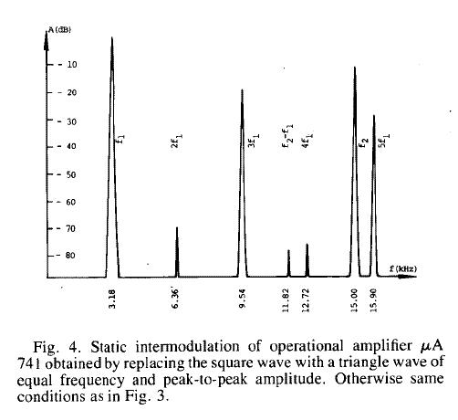

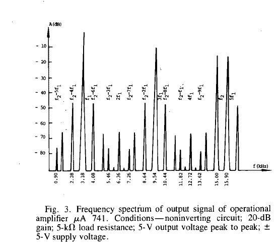

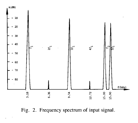

Okay. Leinonen, Otala, Curl.: A Method for Measuring Transient Intermodulation Distortion (TIM)*
3.18kHz square + 15kHz sine, test signal spectrum:

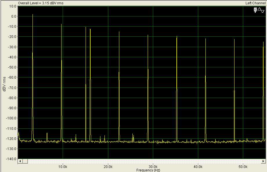

I hate to quibble, CV, but a 2-3dB difference between 15KHz and 15.7KHz with a 100K -3dB down point?
I assume he has generated the signal in digital domain, and used Lynx L22 DAC output.

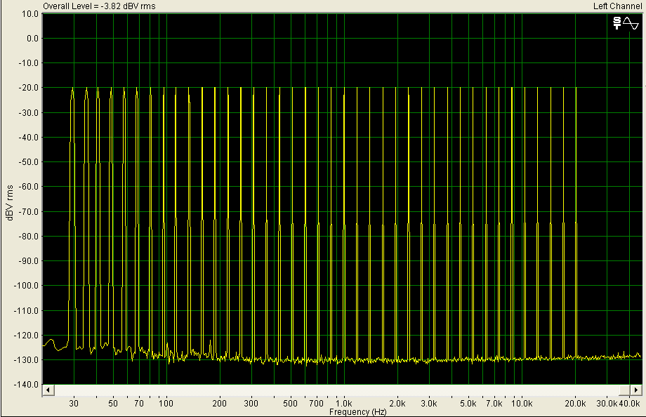

Anyway, speaking about grass, I mean dynamic range of 140 - 160dB. I know it is inaudible at sine. But the high order grass is an indicator of certain type of sound. Multitone with to many tones confuses the issue, 19+20kHz is okay.
