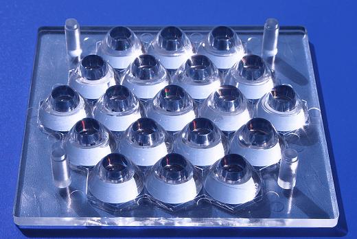

I have been in working on led PROJECTORS for years. Now I found the best way to make an LED projector.
1. a true LED projector with only 19 watts CREE XLAMP LEDs
2. the efficiency is more than 85%,and the uniform is more than 80%
3. The brightness is better than ALLY PTV01, MUCH MUCH BETTER. But to speak truth, the brightness is only 150 ANSI lumens;
4. The image is good. You can see the following pics.

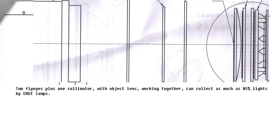

About the collimator
The width=69mm, the length=79mm;
I use the cool white LED from Cree, Q4, and Bin=WA,WK, and WB&WM is also good.
the emitting angle of Q4 from Cree, is 90 degrees. My collimator can collect 85% of the lamps. The efficiency is much much higher than other so-called engine.
I use the Heat-pipe cooling system, and the Aluminum MCPCB.

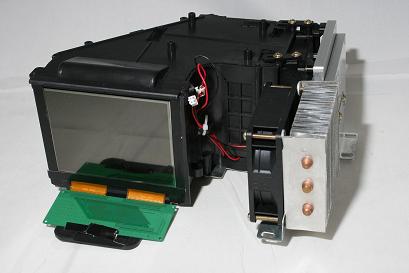

Look, this is what the engine is.
The dimensions of the engine is: 20CM*20CM*10CM(W*L*H).
The LCD panel is there, I use the 5" 800*600 LCD panel.
yes, I can use the Q5, but, for Q5, the color temp bin= wa/wk can not be found. so, Q4 is better, though it is 9% less brighter.
check it.

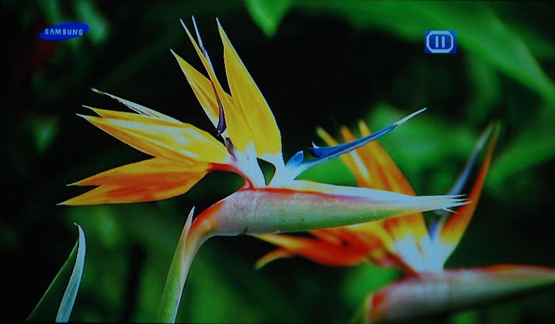

hi,
The image is as following
There is a screen on the wall, and you can find some waves there. And becasue I just use a 600M camera, it is not so good as it is. More pic I will show you later.
I must go to find some other camera

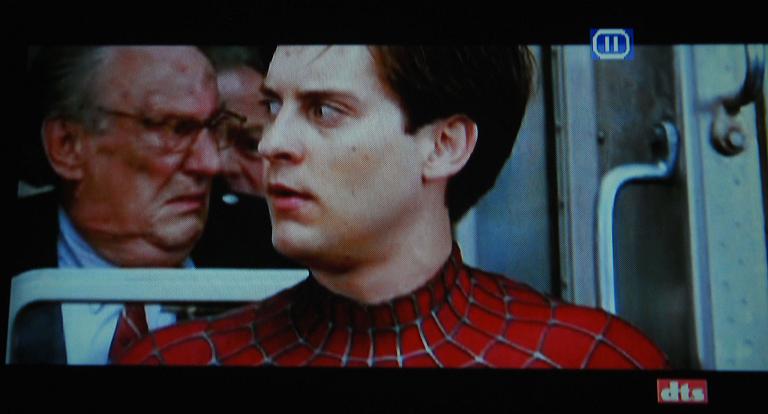

More pics by myself.
1. The uniformity is OK,
2. The environment brightenss is about 6 lux, I turned on a desk lamp behind me.
3. No screen on the wall again,just white wall.
4. an copy DVD popular here in China.
5. I use auto mode( I do not know how to operate an camera), while press down the flash light (not let it flash when taking photos).

1. The uniformity is more than 85%. You can judge from my data listed above.
2. No highlighted spot anywhere on the screen. This is the function and advantages of the flyeyes. There are 2 pcs of flyeyes working together, (back on back).
