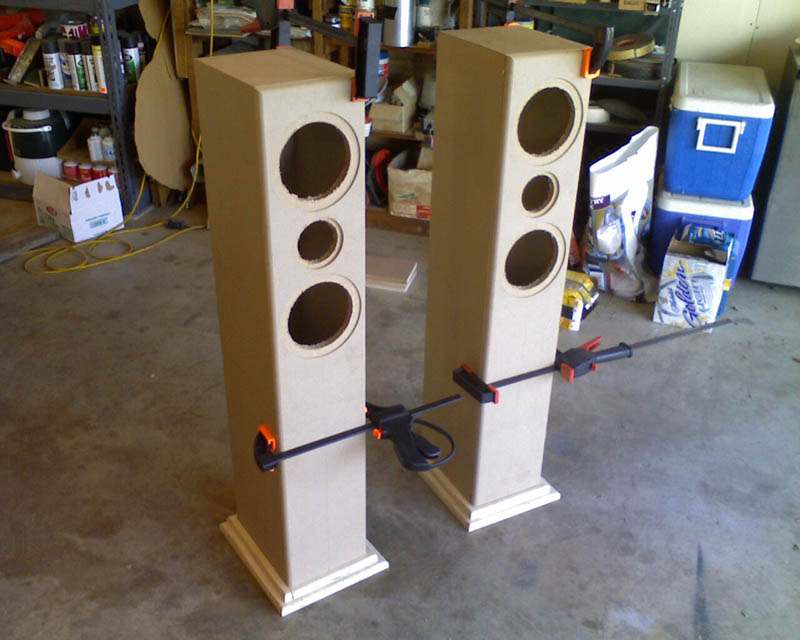

I'm actually working on an identical project, using a Markaudio Alpair5 for the fullrange, and two Dayton DA175s as the woofers.
I have it assembled in a prototype box and have done some initial listening using the variable crossovers in my bench amp. Later this week I'll be taking acoustic and impedance measurements in the box to finalize the crossover.
So far, however, it sounds pretty good. Hard to tell in the garage, terrible acoustics. The Alpair5's +10k hz rise is pretty harsh, in that environment anyway. Definitely helps to stand well back from the speaker, which will be the case in the home theater these are being designed for, but I might tame it a bit with a notch filter.

Nice to see! Regarding your speaker, you will probably have smoother response by moving the Alpair driver off-center a bit, and round-over the baffle edge. The round-over is probably out of the question for your cabinet, as you have screws lining the edge...A cheap metal cone driver is a good option for bass duty, since the crossover should be low enough that you won't have to worry about the cone breakup.
If all goes as planned I'll be building my cabinet early August during my vacation time.

In progress!
just a test-fit. Looking good! need to put holes in the bracing and build the boxes for the mid-tweets.
Center is very similar, need to make the miter cuts, yet, but it's about ready for a test fit, too
