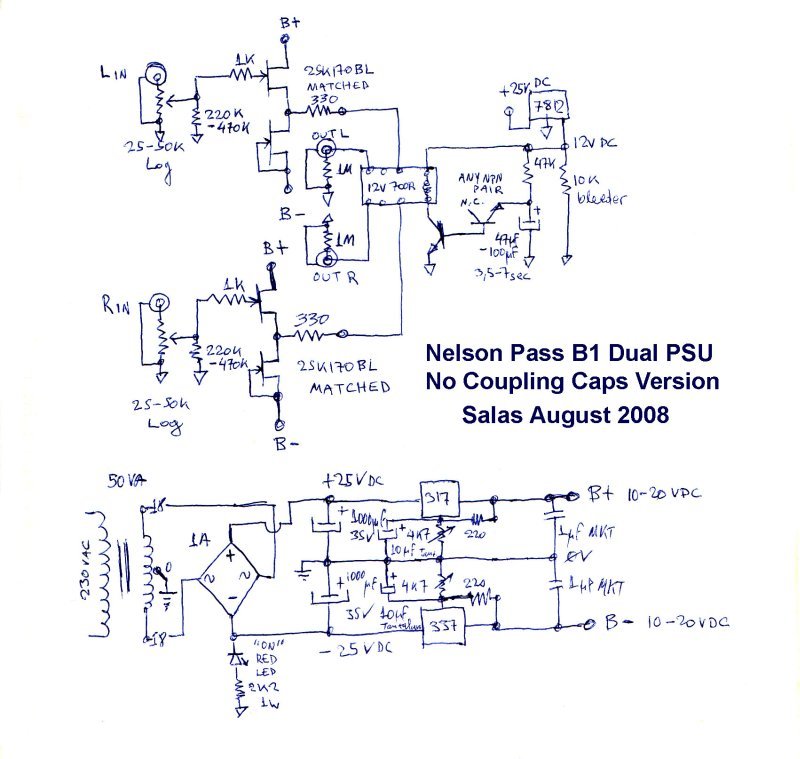

Although I did mail the mods to separate the info on a symmetrical B1 from the standard B1 thread this wasn't done. Info on the symmetrical B1 confused some people so I opened a new thread. Making the B1 with symmetrical ( +/-) supplies makes it possible to go capless or DC-coupled with the B1. Since 99% of standard equipment has out- or input caps this will be beneficial as long as you know what you are doing. So it is not exactly without risks. You've been warned. These are some points as quoted by Salas:
1. By trimming the supplies a bit non symmetric, the output offset falls to either zero or under half mV, steady. It counteracts naturally non perfectly alike JFET pairs.
2. If the applications situation can be non safe (general tests use with possibility of unknown non DC offset checked sources?), an input capacitor only can be used. It will be small value and can be even Teflon and rather affordable. That will obviously guard against most of the danger scenarios and will still be cheaper and more transparent than having an additional big output quality cap. The DC coupled output will not deviate to non safe, unless one psu ceases when in service, or the input resistor to ground is not used and a pot becomes dodgy. Always use that resistor, does good to the pot's transparency too. Hence, a non issue.
3. Each one to his own risks. Situation is well reviewed.
4. Benefits are: Much cheaper, audibly more neutral, more compact.
5. Risks are: If you are not careful and there is no input capacitor in your power amplifier, or DC output sensor and relay, you can burn woofers, if you connect a source device with much DC offset, or one symmetric B1 supply fails during service. Be warned.

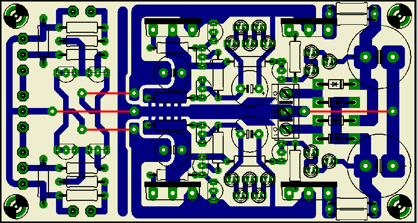

I hope something nice will be created with the schematic Salas designed. Crt ( La Ode ) did a design on the PCB which is not 100 % finished but it is useable.

I was to split it, but I was waiting for the full works from La Ode. He sent me the last stuff just today evening.
The idea started very early in the B1 thread by a ZenMod suggestion. Link.
Then I took it a bit further.
Link.
And I actually made it in P2P.
Link.
This year, interest came back and La Ode made it on a nice PCB.
He is planning a full monoblock version with delay relays and four supplies.

Here is the design in detail.

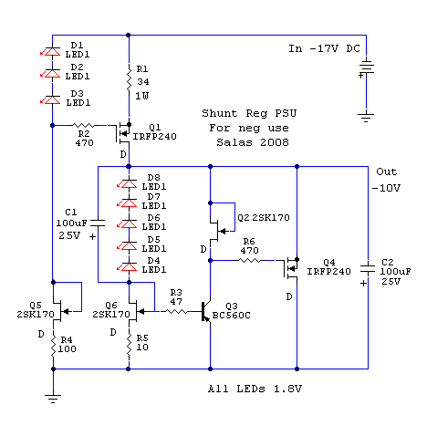

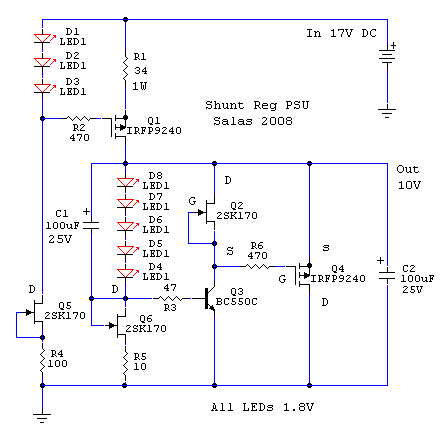

I have calculated that with 60mA CCS per rail (68R//68R=R1) there is no danger at 10V. 60-17mA per rail times 10V for each shunt element = 430mW each. +/- 17mA runs in the audio circuits. No problem for T0-240 devices like those used.
Crt uses 3X68R in parallel, so about 100mA CCS with his 1.87V Leds, at about 11V (1.87Vf gets him a bit high here too). About 1W then.
Nothing burned (50C), but being cautious, he added those:
Just use R1=34R, and no worries.
