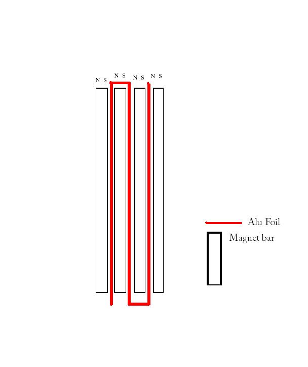

Ok well this image is just to show how the layout should look like, distances and amount of mangnet used an width of foil etc is all just way out of propotion. as you see on the images where i have al the this magnets glued or taped to the metal there are little gaps between the magnets 1 mm thick when aplying the thin foil it wil cover that gap, at the end of the magnet make a turn and go down again, then up the down then up then down until there are no gaps left 🙂
well i played with them a bit, and come up with the folowing results.
its important tot make the turn on the mylar itself, when making the turns with the aluminum tape on the mylar instead of the spacer theres no resoanting aluminum tape, wich whas a problem whem played fullrange.
i can play 3 of them is series wich gave me a 5.4 Ohm DC resistance on a crappy meter. it can play fullrange without anything resonating, but ofcourse you wont have earth shaking bass. it will go as low as 250 - 150 easy. i should get some inprovemend when i stack some more of these panels, like 4 wich gave a healthy 7,2 ohm and another stack of 7,2 in paralel wich gives me 3,6 total DC so for the amp 4 ohm load could be driven by almost al amps. also gives an 6 dB increase in sound pressure 3 for the doubling of speakers and 3 dB of lowering the resistace witch results in a increase of power. handling will be the same as one stack in series at least for the speaker wires. so i think with these efficiency no smoking speaker wires on membrane , first it fries your ears then speakers. the amp is another story but my amp can handly it down to 2 ohms so no problem there.
