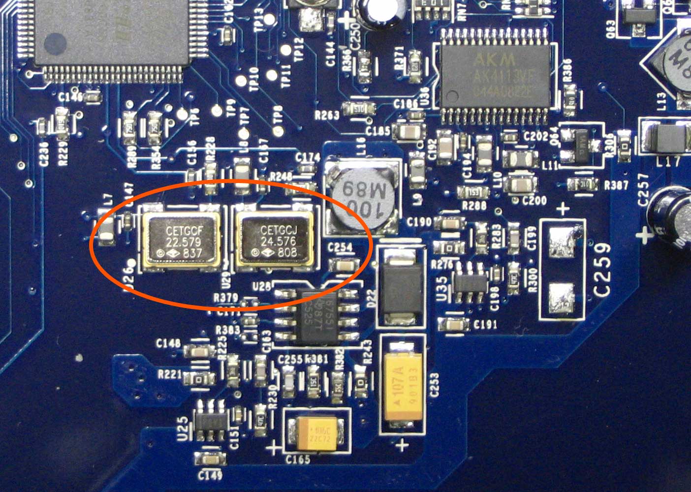

As far as I can see it has no separate clocks for multiples of 44.1 kHz and multiples of 48 kHz. So it must rely on a (digital) PLL anyway with a single crystal.
I have ordered one. Lets see what it will bring to jitter compared to my E-MU 0404, which has separate fixed crystal clocks. And my M-Audio Transit, which is really nasty considering jitter on its S/PDIF output.
Hi Pjotr,
Could you give me any literatures that mention EMU0404 uses separate crystal for 48k and 44.1k? I am curious myself... :scratch:
Hi Pjotr,
quote: "Sample Rates: 44.1, 48, 88.2, 96, 176.4, 192kHz from internal crystal (no sample rate conversion)"
Have a look at the board:
