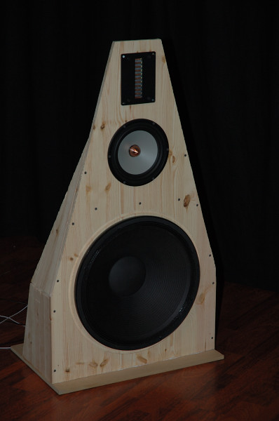

Me and a friend started out with two large pine boards, and three hours later we had two working dipole speaker prototypes. The fastest speakers I've ever build!
We wanted to have a speaker that is true dipole, without using two tweeters like the Linkwitz Orion. The Beyma TPL-150 with the rear chamber and damper pad removed proved to be perfect! It extends more or less flat to 1.5 kHz. Removing the damper pad (which is glued to the rear side of the driver) produced a 5-6 dB peak around 9 kHz, but that was easy to get rid of with parametric EQ.
The midrange is the same Seas W22EX001 used in the Linkwitz Orion.
For the bottom octaves we are going to use a new 21" from Beyma, which has not yet arrived. This woofer named 21SW1600nd was presented at Prolight and Sound in Frankfurt a month or so ago, and production drivers are expected around the end of May. While we wait, a Beyma 18G50 acts as stand-in. The longthrow 21" will produce at least 6 dB more SPL than the 18G50. Not that the 18" is anyway close to bad... there is plenty of bass down to approx 30 Hz.
XO and EQ is run digitally in my computer. There's a long thread on this forum about that: "A how to for a PC XO". XO frequencies are 150 and 1500 Hz, 4th order slope.

This experiment proved to be very successful, so we will of course develop it further! The current baffle is not very stiff, dead or heavy at all, being made of 18 mm pine board... Current ideas are 60 mm MDF for the lower frame (around the woofer), and maybe 30 mm MDF for the upper parts. We are also considering a very heavy base, possibly using a thick steel plate. I think we will keep the "wings" around the edge to further increase stiffness.
This is not a replacement for my big Gjallarhorn 418. I'm builing the prototype with a good friend of mine - it will be his main speakers. I will build a pair for myself also, just because its fun to have a pair.....

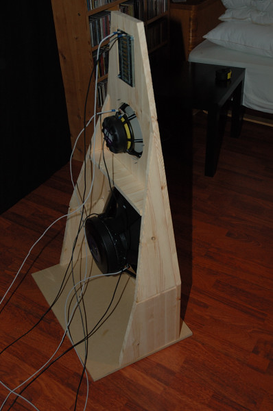

Today I have done some more measurements. The tweeter behaves very well, the only problem is a quite large peak at 1400 Hz, which correlates well to the baffle width at the tweeter height. Thats easy to control with parametric EQ, so I dont worry.
Whats worse, is a series of nulls and peaks in the midrange. There are nulls/dips at 300 and 900 Hz, and a rather large peak at 600. This also correlates well with the rear to front distance around the baffle. There is a bit too much of these peaks and dips, I would like to avoid that. Is the only solution a wider baffle? I did not see this that obvious when I measured the W22 before we cut of the edges to get the pyramid shaped baffle (we started with a rectangular board).
Any ideas regarding the midrange problems?
The bass works fine, much better than expected. There is however no point in adding EQ lower than 30 Hz, as we run out of cone excursion very very fast.
Found the source for the 300 and 900 Hz dips...: the floor bounce... 😱
The large 600 Hz peak remains, but thats easy to control with EQ. Actually its 500 Hz, and the cure is a 9 dB dip there. Yes 9 dB. The speaker is unlistenable without EQ here.
And now - with a pair of absorbers on the floor, it measures a lot better, and its starting to sound really good!

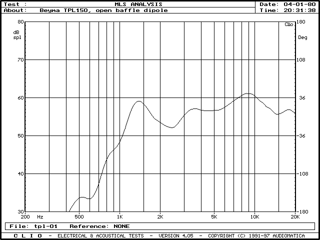

StigErik,
Could you post your measurements of the TPL-150 with open back? It might work in my dipole design. Currently I use the BG Neo3pdr open backed but it is rather low in sensitivity and the PHL 1120 mid I'm using needs to be padded down quite a bit. I'd thought of using two Neo3's stacked in series but maybe the TPL-150 would be better. Do you think the TPL-150 sounds better than BG Neo3pdr?
Sure, here it is. Not as flat as 10$ domes though, will need some EQ. The peak at 1.5 kHz might be a bit alarming, but I cross at 1.5 kHz without any obvious problems.
I've used the Neo3 in quite a few designs. I like it, but it cant match the sound quality of a good AMT like Mundorf or Beyma.

On my design, we initially used the Neo3 and Neo8 just experimenting, and they do sound great when used within their volume limits. We needed quite a bit more volume and better dynamics, so the TPL-150 was the way to go. I meant to try them dipole before the studio monitors were finished, but never got around to it.

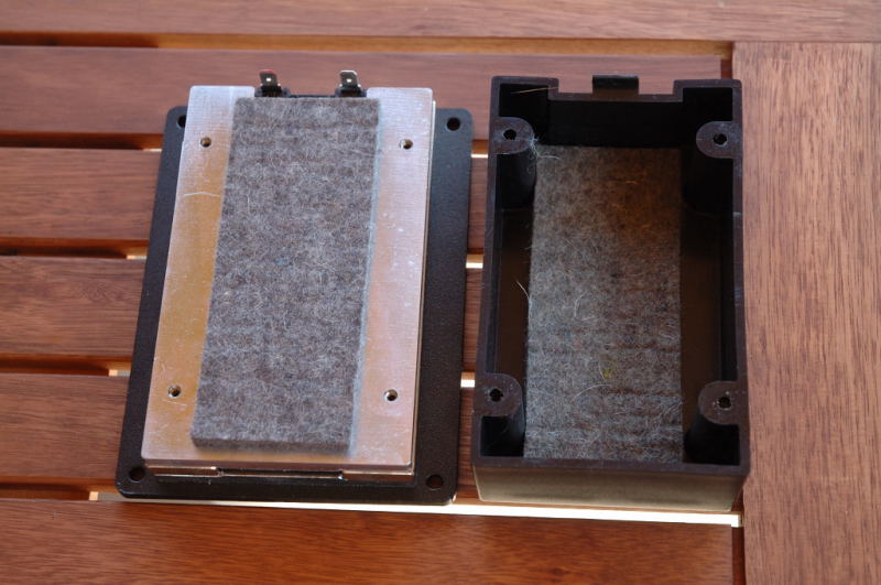

Removal of TPL-150 rear cover
StigErik, I have a pair of the Beyma TPL-150 and I would like to remove the rear cover and give them a try as dipoles.
Could you tell me a little about your experience with removing the back covers of yours?
I obviously absolve anyone here of any responsibility if I accidentally murder one of my TPL-150's...
:yell:
Thanks in advance.
Martin.
Removing the rear cover is safe and easy. Just remove the four screws, and lift the cover off. To fully modify the driver to become dipole, you will have to cut away the read damper pad as well. This is not very tricky either. Use a sharp knife to cut between the pad and the magnet. Be aware that the magnets are very strong.
Whatever you do, make sure you don't loose any magnetic things like screws into the driver, as these will destroy the driver! The older TPL150 did not have a wire mesh grille in front, the latter ones do have this for protection. On the rear side there is no grille, so if you take off the rear damper, you might consider installing a wire mesh grille here as well.
