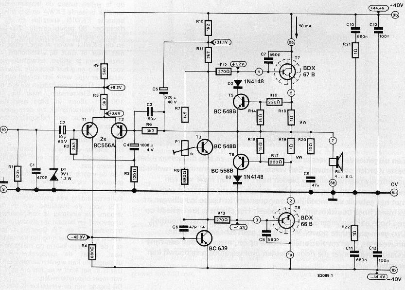

in the year 1987
i ve met with one of these amplifiers created by elektor and used BDW83-84C as outputs ...... if i had to name this amplifier i could just as well name it : THE ULTIMATE SONIC KILLER !!!!
been constructing this amp for 3 times in the far past last time i think 8years still own it and having to change the outs to a more reliable MJ11015-16 which actually improved a lot as about durability and done nothing about the sound ( expected )
may be now days with more expirience i will take a look at it gain to see if there is something missed or done the wrong way .
What is trully noticable about this design is that has everything tha will kill your sonics
---- strange input configuration
---- then classic and effective VI limmiters ( from asafety aspect )
---- large base caps located in the output transitors
---- finally huge 1R 10W balast resistors that actually support my above comment that a darligton will behave in a strange way depending on temperature drive and others even though given as a fact thata in a elektor design the best of material is to be used
compaired to the above NP selections of output resistors 0R68 in a configuration of 2 xTIP142+2XTIP147 used as outs looks more than proper
then again elktors design is AB issue and A40 is a classA issue there i can presume and please someone correct me that if darligtons are too busy keeping on with 400ma idle/device may be they dont have time to oscilate .... hell !!!!! i lost my sleep on this ......

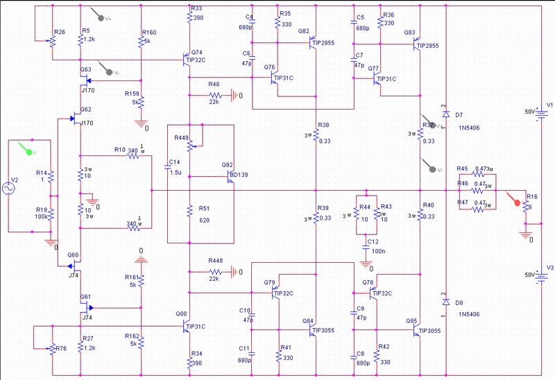

sudenly and out of the blue this post and this schematic comes up very related and have alot in common as an idea with the A40 even though one is classic double darligton and the other is sziklai double darligton please find attachment and related link at the end .....
strange but the claims that with BD249-50 and other related slow devices circuit is woorking but with modern fast transistors runs in to oscilation problems

sakis,
Yes, there is a problem with driving paralleled devices. Less amazingly, each master device does not have its own driver, does it?finally remains a another question about something i read in the forum that as an idea to each output BJT having its own driver provides amzing drive to an amplifier
Re: in the year 1987
Looks like he just threw whatever models he had into the simulator. And then tuned up the lag comp until it "worked". The topology was good (as Nelson Pass commented), but it really needed the right (faster) transistors to get the performance it's capable of. And the compensation would have needed rework. Give someone who knows what they're doing five minutes with an oscillating prototype and they'd have it working. With the fast transistors.
sakis said:strange but the claims that with BD249-50 and other related slow devices circuit is woorking but with modern fast transistors runs in to oscilation problems

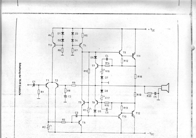

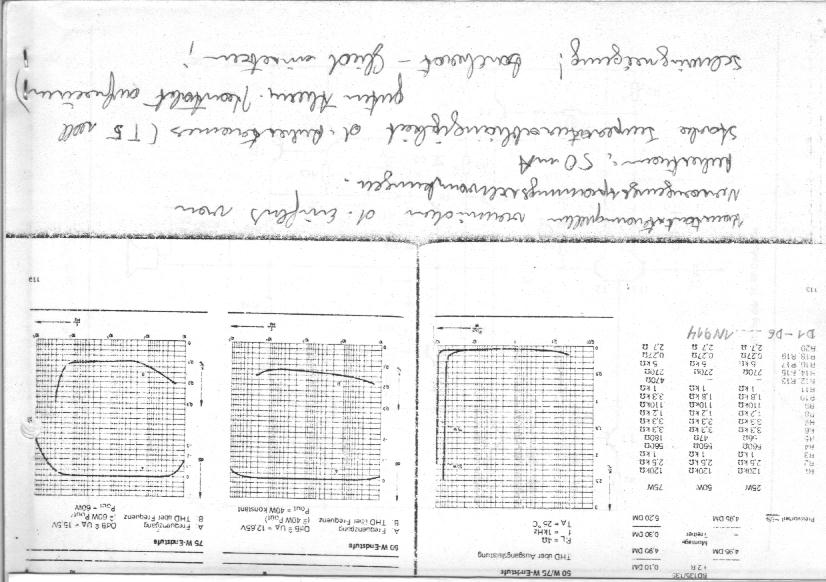

hello.
i have built an a40 with tip141/146.........
there is a schematic i found in a texas inst. amplifier book (from the eighties i think),the output transistors t11,t12 are tip 141/146.......(t9,t10 =bc182,bc212 ; t6= bc182 ; t5 = bd135 ; t1...t4 = bc212.
greetings..............
hello.
it is a standard application power amp ,designed by tex. instr.
they compared the costs of a discrete output stage (tip33/tip34,bd137/bd138 plus resistors) against the tex. darlington tip's.............the darlington's were a few percent cheaper...........

...now here is some one that knows his ways around darlingtons ... this car audio amplifier was given to me by a friend ...
It uses 2 pairs of BDW 83C-84C/ch with all the well known stability issues BUT!!!
---uses 1 Ohm ballast resistors quite big but better safe than sorry .. differences that occurs from the nature of the darlington may consumed there
---uses Bd 139 as vbe multiplier which is a s good as any other NPN transistor but for sure offers the best and secured way of mounting on the heatsink .
--- uses a Vi limiter
--- uses Miller caps located as close to the outputs between B -C
now ... to my understanding ...if you want to make darligton multioutput amplifier this is the one and only way ....
regards sakis
