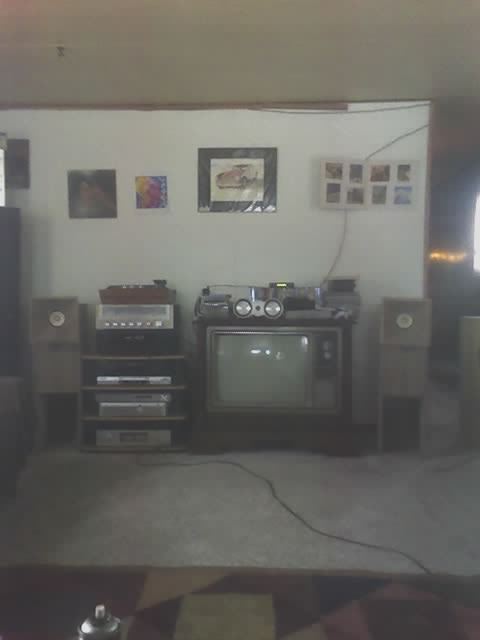

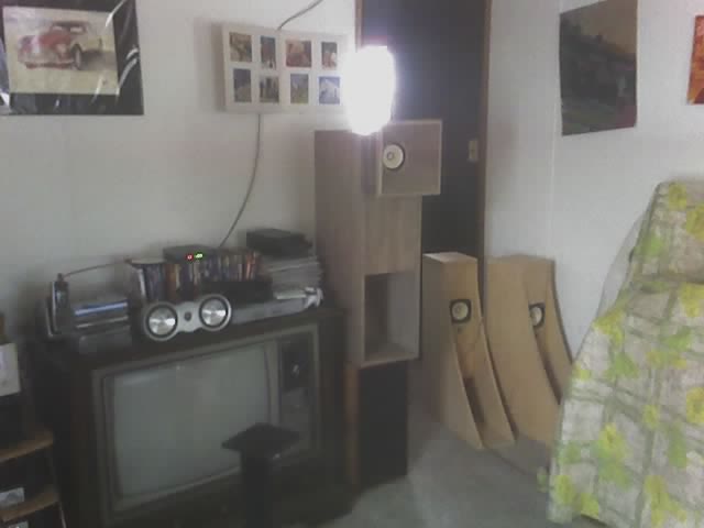

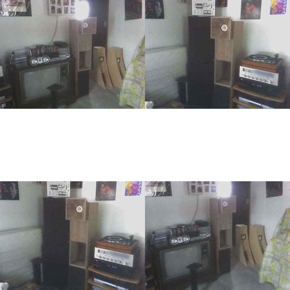

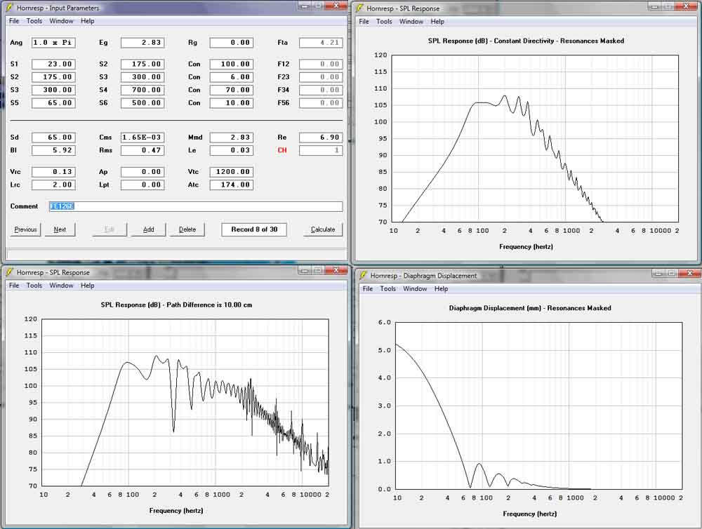

Heres the pics I promised of Dougs speakers with the addition of the front horn. Previously the bass over powered the higher mid and treble frequencies so I used hornresp to model a front horn for the 126s. I was having trouble getting one to come out well but then I remembered that hornresp assumes your driver is a flat piston and therefor doesn't model the treble response correctly so I looked at how it modeled the 126 and looked for the response to come up about 10db from 300hz up to 20000 to match the bass output of the rear horn turns out a simple conical horn did the trick. When Doug brought them over yesterday and we hooked them up to my Marantz receiver at first I was really disappointed with the sound They seemed extremely directional, didn't image well and that midrange magic seemed to be gone. Then we discovered that one of the speakerwires was connected to the driver backwards and they were out of phase. After fixing that they sounded alot better but seemed to be lacking the bass slam and dynamics I had remembered them having at Doug's shop. Then we discovered they were out of phase with my subwoofers. After that it was pure magic. The Marantz puts out 30wpc but that was far more power than these baby's needed my subs cried uncle long before the horns showed any signs of strain. Once everything was connected these babies sang like nothing I had ever heard. Now that we have the utmost confidence in Hornresp and Fostex drivers it's time to get really creative and make some art!!

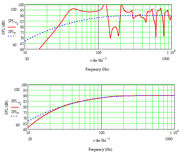

Fair point David; FWIW, I'd say it's possible to design a TL empirically in Hornresp, but you'd have to be careful. Just make sure you're going for loads of gain with the undamped pipe, because that is going vanish rapidly with the addition of viscous damping. For e.g. top of attached = undamped QW pipe, bottom = same, damped to become a TL.
Better yet would be to size your pipe with Martin's alignment tables, then run it through Hornresp for a graph etc of the undamped line as required. Takes some of the guesswork out of it.

Without seeing the design, I can't really contribute anything that'd be particularly worth reading. FWIW though, considering the back-horn, you appear to have tuned to a relatively high frequency rather than attempting to squeeze ultimate extension out of it, which is usually quite a good idea. If, as it sounds, it's a high-gain design, then mating to a front horn to form a compound design is also a good idea if done correctly. Conical is usually my own favourite for the latter, given it's lack of distortion. Just keep an eye on driver excursion, the 126 has very little linear travel.
