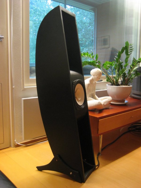

I recently had some CNCing done for a project. I used 24mm BB ply, and used a similar laminating process. The finish that you can achieve having sanded, stained, sealed, sanded, sealed again , sanded, and finally wax polished, is beautiful and very satisfying.
One caveat: Even with the finest CNC tolerances the edges need some work to get smooth. This is obviously important where you can see, for aesthetic purposes.
Is it important to have a smooth interior? Access to sand the tight parts will be difficult. My narrowest part was 120mm wide, and I was glad that it was not any less.
The flash photography makes this look rougher than it is. It is silky smooth, and shiny.
