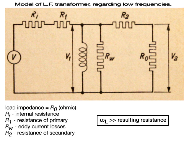

To determine just which OPT you want to obtain, you have to consider the actual working load that the transformer provides to the tube. Reflected load is one component. The RP or plate resistance is another part and the actual DCR of the OPT primary is the last part. If you add the reflected impedance (Rl) in parallel with the Plate resistance (Rp) and then add that sum to the primary DC resistance of the OPT as a series added resistance, you will have the complex impedance load that the OPT primary must provide to the tube plate.
To determine which transformer will meet this load, divide this impedance by 2 X pi and the lowest frequency of interest (i.e. 20Hz). This will provide the amount of inductance you need in the primary. But, this will only provide for a -3dB performance at this point. To obtain a -0.5 dB performance you must have 3.63 times this calculated inductance. But, you only need this amount as a maximum performance number, under load and making music.
Now, most inductance values quoted are at a minimum flux point of 1 vac and 120 Hz. A gapped core transformer rated to handle 20 to 40 ma DC will typically have twice this measured inductance, as a maximum amount. An un gapped transformer will typically have 10 times this amount as a working maximum. For SE you must have a gapped transformer.
So, when looking, make sure you know what the expected primary inductance is and how they arrived at that number. Is it measured at 1 vac & 120 hZ, as most mfg's supply, or is it the maximum loaded operating number, as Lundahl typically provide? Then you need to determine the plate DC current that will pass through the OPT primary and make sure the OPT is designed for pretty close to this amount, not more than 1.5 times that current number.
If this doesn't click in your head I can do the math for you too. But I think you should go to Franks Tube Data, down load the appropriate tube data sheets and struggle with this actually fairly simple problem, so you have it down cold, for future projects.

Experiencing the low roll off described by Kevin with a standard 5K:8 ohm, I wonder if output transformers exist with suitable inductance to overcome this problem. This model of the OT describes the effect: to fall of at 20Hz
2 pi 20 L >> resulting resistance network

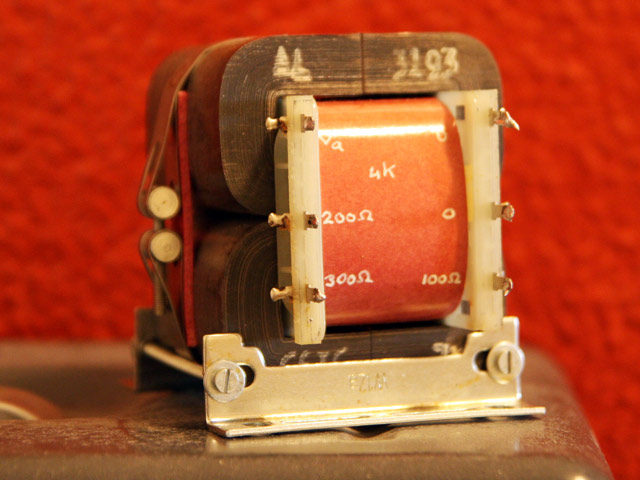

Hi Bud,
Thank you for helping out here, the money's already spend though Got me some C-core SE 4K:100/200/300 usable up to 50mA DC current. Fired up the old Wayne Kerr component bridge and the primary holds 20.5H, Rpri= 314 ohm, Rsec300= 44 ohm.
I've used these OT with good results on 400 ohm speakers with 1626 triodes (Ri=1K6). Looking at this headphones amp I got the idea to power my 300 ohm Sennheisers with them. Bass was lacking though. Ri of the 12B4 is about 1K ohm (25mA), Vplate 250V.
Will ask the producer about gab size and permeability but the answer won't come soon I guess.
Jaap

disco,
Your inductance is fine, you only need 19.5 henry for the 890z ohms this tube requires. Your load line is pretty steep though, some four times what the plate requires for A1 operation in SE. That, coupled with the rather high secondary DCR is probably what is causing the loss of bass. Just not enough power to drive the load with the reflected loses in the transformer.
When you provide a tube with a load line that accentuates the voltage output and then provide also provide a lot of DCR loses in a transformer, for that voltage to overcome, you have this result. Your turns ratio provides a 257 z ohm secondary output, when loaded to a 12b4-A tube with the turns ratio you have specified.
It is a mistake to assume that the transformer should be physically small because the power going through it is small, when involved with tubes. They are a voltage device, using the transformer to convert the voltage biased character into a current biased character and so are very sensitive to transformer DCR. The transformer for your needs should have about 100 ohms max in the primary and no more than about 10 ohms in the secondary.
Bud
Hi Bud,disco,
Bud
Would some more power bring better low end control with this peculiar OT? I'm thinking about the 45 triode for which a 4K load would be practical. Won't the high output impedance cripple bass control, driving 300 ohm headphones?
