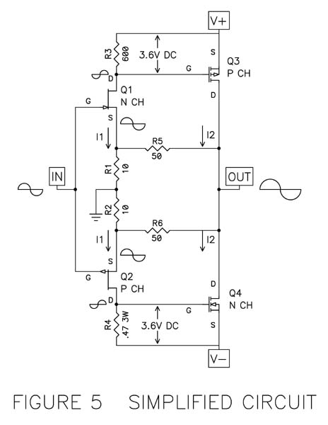

Here's a copy of the simplified circuit.

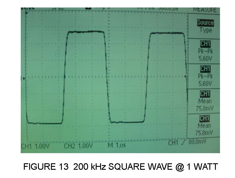

However, I don't want this to become a best wishes thread, rather
it should focus on what I think will be an exciting little amplifier.
In case you haven't already seen the square wave....

EUVL said:
All the best for a speedy recovery.
The simplified schematics looks familiar though ?
http://www.diyaudio.com/forums/showthread.php?threadid=59339
PS I think R4 should also be 600 ohm and not 0R47.
Such a smarty-pants. Yes, it's 600 ohms (it's correct in the not-
simplified schematic).
I had not seen the Profet schematic before - when the ads came out
I noted that it supposedly "all the benefits of a current source
and voltage source" and I didn't give it further attention.
An email correspondent some years ago also suggested this
topology, a CFP with voltage gain. If I could remember his name I
would have mentioned him. (who knows, maybe it was the Profet
guy...)
Anyway, it's been around for a while. When you read the F5 article,
you will see "The topology is familiar...". Selectronics has chosen to
bridge the circuit and settled on different values.
Given the differences in measured performance from "Chuck"
Hansen's review in AudioXpress, I suspect that they were using the
same kind of gun to shoot at a different target.
