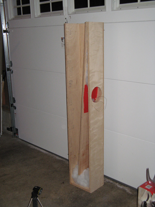

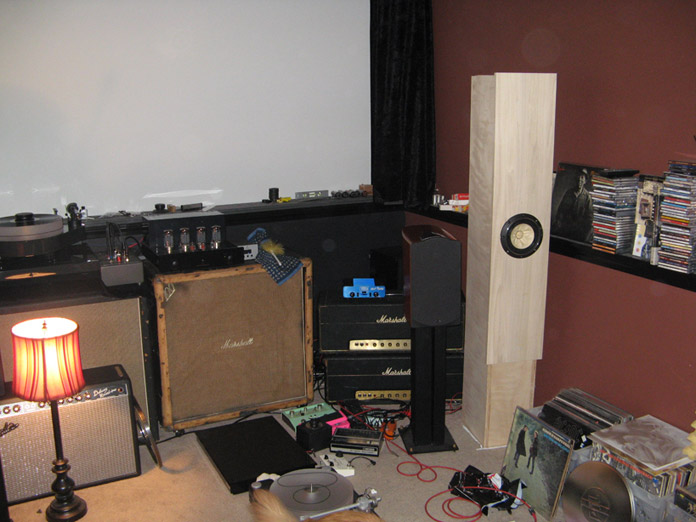

Spent the weekend building my BIB speakers (thanks Godzilla for the help). Very simple and easy to assemble. I've had the Fostex 168 sigmas in a spiral horn that I made out of (don't laugh) extra thick foam core and it sounded horrible. These are MUCH better! :) Fortunately it gave me a chance to break in the speakers so I've already got over 100 hours on them.
The speakers have deep bass, huge sound stage and better imaging than my Paradigm Signature 2s (former Stereophile class A monitors).
I do notice some coloration with the sound though. I think it's that "cupped hands" thing that I hear mentioned a lot. Almost like a "plastic" sound. Are there ways to remedy that?

Enjoy! I think if you double up the back of the cabinet to reduce vibration you will reduce or eliminate the cupped hand sound. If you feel too much midrange is coming out the top continue to add stuffing in small amounts. Go to this website:
http://www.phys.unsw.edu.au/jw/hearing.html
If your computer is connected to your stereo you can play the test tones from 250hz down. These are the frequencies you want coming out the top of your BIB. Stuff your BIB until you reduce the frequencies above 300hz. I posted the test tone link here:
http://www.zillaspeak.com/bib-howtobuild.asp
Scroll to the bottom.

Compared to the Paradigms, they image better, produce a bigger soundstage, and have deeper bass. On vocals and acoustic guitar they just shine, but on some stuff I hear that midrange coloration. I could easily live with these over the Paradigms but I'll probably hang on to them just to have something different.
They kind of remind me of electrostatics!

I used 3/4" baltic birch for the enclosure and followed these dimensions http://www.zillaspeak.com/bib-fostex.asp
I actually built the shorter one but will probably do the larger one next.
Height was 64", width was 7.5" and the depth was 10" (internal dimensions) and the space at the bottome of the fold was 5". The face is a just a solid piece of poplar from home depot. You need the extra thickness to keep the back of the driver from touching angled panel on the inside .... and it covers mistakes. :)
Hey Godzilla, I felt my cab last night and did feel a lot of vibrations on the back. Is it best to double it up or do some kind of bracing pattern?

FWIW, some of the Fostex/Nagaoka designs incorporate interesting combinations of double layers of material / standing rib* bracing, particularly on back panels of larger horn cabinets.
* several strips of material (usually plywood) laminated to form something like an approx 2x4" rib, attached edgewise to the rear panel
They also do some curious things with enclosure side walls - overlapping layers of uneven sized pieces to achieve a thicker compound panels.
It would be interesting to see measurements of the difference in resonance distribution / attenuation for such fabrications, compared to more conventional construction.

flush mounted?
I can't see if the Fe167 above is flush mounted.

If you're talking about flush mounting a round driver like the Sigma series, it would likely be even easier to just make 2 concentric passes with a simple circle jig (i.e. Jasper jig, or shop made compass style).
With a shop made jig in MDF (the best use for this material yet!), and a router with plunge base or accurate depth of cut gauge, you can use a wide mortise bit and make a single pass for the outer rebate, and then follow with the inner cut for the driver opening.
10 minutes and you're done.
