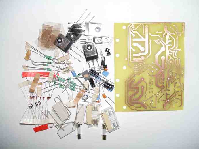

Hi folks,
So here it is. With photos and full documentation.
My amplifier design, called "ST151", that uses cheap and easly available, industrial standard parts.
I gladly suggest to build it for anyone.
(Please don't flame the thread with any audiophile modificaton. ST151 is not a state-of-art design, uses nothing new or special circuit. But it's designed properly > good sound quailty, cheap parts, stability.)
[First attachment: parts list, performance, etc.]

So, as an estimate, whats the cost for stereo amp using this circuit minus the heatsinks and case? I'm not very knowledgable in the design of amplifiers but i can build and work on them. I've been keeping my eye out for something i could use for the upper half of my semi-active 3 ways and this looks like it could work...

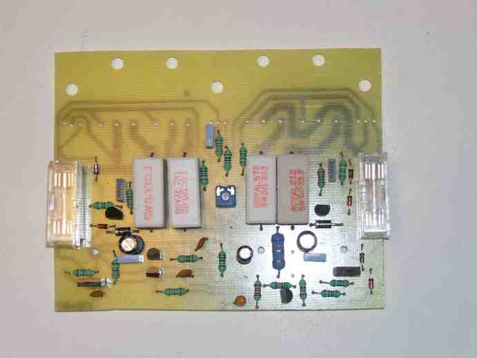

Good schematics... 😀
I think for max 250W with a low impedance spk. (4 Ohms)
The difference between the two PCB is the position of P1 ?
bye 🙂
bye 🙂
