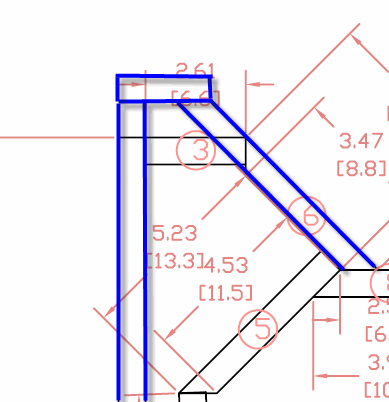

Since we need to extend the top back of the CC to get to the recommended 2.2 liters volume, its shape changes from that nice triangular profile to a stranger, elongated shape.
My question is if the _shape_ of the CC is important in any way.

Yes it is. I dont believe in flat panels which reflect a wave back to the driver. My original idea was to reflect the wave thru an absorbant medium at the rear of the chamber.That or an object that would disperse the higher frequencies.
Simply line the rear of the extended chamber with 1/4"T balsa with a thin layer of felt on top. The area in the rear would be 1/4 the length of the chamber.

Ron,
Many thanks for chipping in
Only the top part ike in the attached picture of Dave's modified CC ? (With the corresp. volume correction, of course Didn't have a better image at hand) Or both that part and the bottom sloped part (i.e. the part sloped towards the exit of the CC) ?
*Ahem*.... Not sure I follow...You mean the lining should go for the whole width of that part (i.e. width of the front baffle) and for a length equal to 1/4 of the "max depth" of the CC (when seen from the front baffle) ?

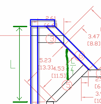

ronc said:Simply line the rear of the extended chamber with 1/4"T balsa with a thin layer of felt on top.

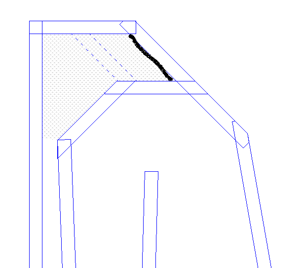

Since I got your attention, another quick question:
Another possible way of increasing the CC volume up to the recommended 2.2 liters is by extending the CC upwards like in the attached picture.
Any preferences compared to the above "elongated" CC ? Lining of the back of the CC in this case (as per above) ?

ronc said:The area in the rear would be 1/4 the length of the chamber.
Or like this, parallel with the front baffle ?
The first image is correct but all around the rear of the CC. The idea is to reflect as much of the wave as possible thru two different mediums. The first medium has a lower density than the second, this provides for a greater BW of attenuation as well as greater attenuation of the higher frequency waves.This is termed "progressive attenuation".
Example! Ever see the grouping of barrels on the median of an off ramp on a freeway? The first set of barrels are filled 1/4 with water,the second 1/2 full and the third full. This allows a progressive damping of the forward mass/velocity of the auto.
