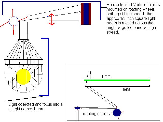

from the post on using laser beams for a projector I had this idea. Instead of using a light source on an entire lcd panel to provide light to project the image, why not use a norrow beam of light and move it rapidly across the panel. Instead of using a 575w light to light a 10 inch panel, why not focus the light down to say 1/4 of an inch and scan it across the panel like a crt. it would be a large device but if it works would yeld a very bright image. I enclosed a very rough sketch of the idea.
That will work
You cannot focus your beam into a collimated beam any smaller than the original light source but since the arc lenght in a Metal Halid is 7mm that is small enough.
You will need a high speed on your rotating polygon to sweep a screen at sufficient rate to avoid flicker.
Can be done if you are keen.
Have a look at my thread Laser projection for some details on cheap polygons etc.

To that end, I am not sure what the benefit of the described system will be.
I will educate you. Pay attention.
mikejz84 says why not run a beam of light across the panel.
Ok now as everyone knows the pixels in an LCD are active whether there is any backlight or inline lighting or not.
So if you shone a tourch through the panel you would see a small area of picture. Not very helpful.
But if you rastered a light beam across the panel persistence of vision would let each illuminated area stay in your brain and you would still "see" a part of a picture even when the moving light beam has moved on. This is an essential part of CRT TV viewing.
Now sweeping out a picture has been tried many times before using moving light beams dating from the early 1930's with some success. However the thing that is hard to do is move a beam of light with the precision to draw a picture on screen with sufficient accuracy or speed. Big dollars involved.
But mikejz84's idea has a chance of sucess because he is only trying to illuminate a part of the LCD that already has had very precise electronics set the pixels.
He can come in with a much less precise device and illuminate not one line but several lines per sweep maybe 20 lines would be practical.
Now the essential thing is normally the light from a source is spread out over area X, but in mikejz84's idea he can concentrate all his light on a much smaller area thus acheiving far greater brightness per unit area and consequently you see a much brighter picture.
Of course he has to be above the flicker rate and it would take a lot of good engineering but it is possible.

I am aware of the perceived brightness increase from using a pulsed light source of higher peak brightness but the same average power. That will be a function of repetition rate (or frame rate in this case), and duty cycle, or spot size in this case. Would need some playing with spot size to achieve the best results.
My concerns are more about optics and mechanics. All pixels in the TFT are always active. For that reason, the spot that is generated must be a perfect multiple of the size of a pixel which will be pretty difficult to do. The other thing is that the scanning mechanism must be sub-pixel accurate. If either of these are not true, then you will have overlaps between your scans and will end up with hot (brighter lines).
The other issue is that the spot will need to be very even in terms of illumination. If it is not, as opposed to having slowly varying brightness, you will have rapidly varying brightness on the display which will be very perceptable to the human eye.
You will also have the issue of illumination angle of the pixels changing significantly from the inside to the outside of the display which will create brightness variations as well as brightness variations due to surface reflectance. You can fix this by moving the scanner farther from the display. This is different from an OHP where you essentially have a diffuser behind the display to ensure an even lighting condition for all pixels.

I disagree
The idea has a lot of potential, has fewer problems than line by line scanning, would be relatively easy to implement and gives either a much brighter picture, or allows the use of lower wattage light source.
I agree with your thoughts on accurate scanning to overlap the light paths and I am not saying it is easy but the essence is using persistence of vision to advantage.
Ordinary leds can be pulsed as long as they stay within the average power ratings and this is done in for example systems for creating a beam across a doorway. Output from DC powered LED is much too low for anything past a few meteres yet pulsed one IR led transmitter can easily reach 20 meters. These are sold commercially. I have my own system at home. Details available if required.
Taking then the full output from a 400 watt Metal Halide to illuminate an LCD ow this works. Now consider if the beam were reduced to half diameter and shaped and scanned only the top half of the picture and then the bottom half.
It would not be all that difficult to acheive a seemlesss match at the half point and the light beam power per unit area is now doubled. So we now have an apparent 800 watt light bulb. Taking this to an extreme one could reduce the light to just one line and on a VGA screen you could be looking at approximately 400 times increase in light per area.
Or another way or saying it is a 400 x 400 = 160,000 watt light source
This increase is far beyond what could be obtained with an LED pulsed system.
Possibly 10 - 20 scans could be done with modest outlay. The advantage being a much brighter picture, a much larger picture capability, or, for a given screen size and brightness level, a much smaller bulb wattage. Perhaps even down to a 40 watt MH. Much less heat. Much less electricilty used.

While the eye does respond to peaks, this is not a linear response. Reducing the spot size by a factor of 400 and increasing the brightness of that spot by 400 times will not yield a 400 times increase in brightness. It is a complex relationship, and you can possibly achieve an increase in brightness of several times. I will dig through some of my SID literature to see if I can find any papers on it. I can vaguely remember a paper that discussed this on that other topic, scanning laser displays. If it was a purely linear relationship, you could use a low powered laser, but unfortunately, you still need a fairly high power level.
I would like to hear your thoughts on how you will achieve a spot size that is a perfect multiple of a pixel width, and also how you will move that spot a perfect multiple of a pixel. Even in a commercial application this would be very very difficult, for a DIYER, it may be impossible.
Have you considered this? As you scan that spot across the display, the distance from the light source\optics to the display will change. That means the size of the spot will change. You can reduce this to some degree with optics (now becoming quite long in order to achieve good collimation), but you are likely going to need to reduce the spot size as well such that changes in size are smaller w.r.t. a pixel.

Quote by alvaius
If you start of with a light flux of a certain value on a large area then concentrate the same illumination on a half sized area you will have doubled the flux. The fact the eye does not perceive it as double the flux because of its logorithmic nature is imaterial.
What I said was it would be equivalent to a 400 x 400 source and that is perfectly correct. I never said it would look 400 times as bright

Actually I understood exactly what you mean't. It will not be effectively like a 160,000 watt source. I should look like a lot more than 400 though.
In terms of being positive, I think you are on the right track by only scanning in one dimension. It should make the overlap issues go away. It will be analogous to a focal plane shutter in reverse. The best results will likely be achieved if you follow the refresh by a little to give the pixel a bit of time to change. It will not settle in a frame time, but you can at least get a good portion of the transition in...
I just thought I could check back at the thread I have started here, I must admit I sure did learn a lot about my own idea! Anyways I do have some observations for you. The main area of objection concerning this idea is how to uniformly scan the light so that pixels are illumined evenly during a scan. However, while the idea is based on a crt, it is not a crt and crt scanning rules do not apply. I propose that instead of single pass scans, instead do multiple scans. The idea is to scan one axis at a higher rate then the other. For example, why not scan the vertical 20 times faster then the horizontal, and between every vertical scan move the horizontal 1/20th the width of the scan beam. That way instead of having to worry about a pixel being double scanned, and thus creating hot-spots, because each pixel will be scanned 20 times, the threat of slight misalignments is not much to worries about, the odds that a pixel being scanned 21,22,23, 24, or even 25 time being notice while others are scan 20 times is quite negligible as compared to a pixels scanned one or two times. Currently, I am not in a position to being work on this idea on my own, But I really thing that this is a idea that needs further development and I appreciate all of your input.
I think what remp proposed of only scanning in one dimension may be the easiest and most practical thing to do. You have to be careful that you are scanning somewhat in sync with the image being drawn on the screen. If you do not, you may have funny image artifacts. Depending on what is showing up on the screen, this may be minimal, i.e. if the image is static, but if there is a lot of motion in the image, it could be substantial.
