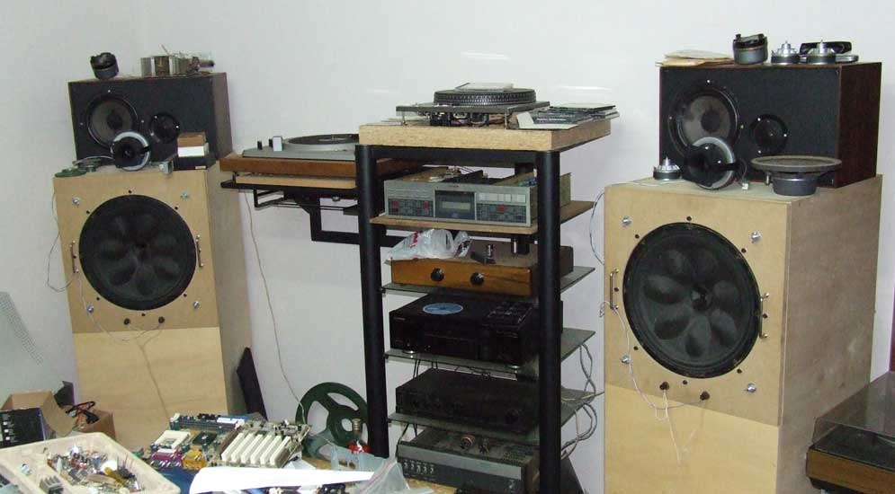

on attached pic you can see pair of old ITT boxes (layin' on top of biggies) ; they're in fact OEM from Scan Speak, inside them are 21W38 and D3804 ,both Alnicos ; box have somewhere in the middle horizontally placed baffle,with rectangular hole,covered with sorta tiny felt .....this is certainly sort of inside aperiodic jobbie; x-over....naturally series one
touch of the Genius, Scaaning-who else ........(confirmed from his son )
after recappin' and repairing slightly damaged cone and surround on one woof, I made sorta DIY variovent on back of each cab ; that improved further bass from cabs.
but-comparing to biggies on pic,little boxes still have too much boxiness......meaning on medium freq. range........

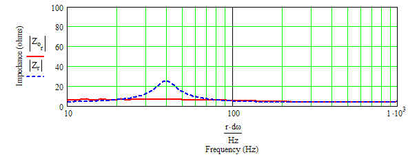

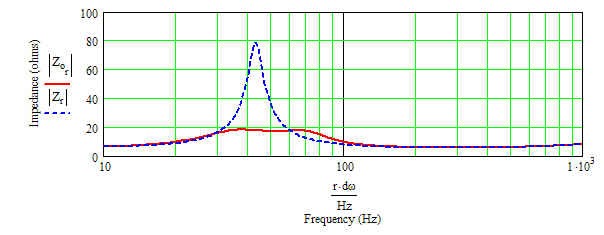

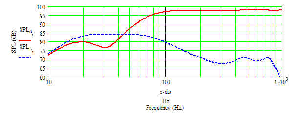

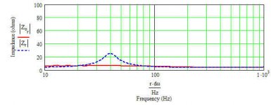

Aperiodic literally means without period, so the only way I know how to do this acoustically to a point source driver is with a 'perfect' BLH, though a max flat impedance tuned TL does a pretty decent job of it, ergo in reality aperiodic normally just means either a well damped impedance peak or flattened underdamped alignment, hence the mellow sounds emanating from the vent.
GM

Greets to you GM. Thanks for the graphs. I have just done a sweep and calculations.
159 Hz 8.2 ohms
133 hz 8.2 ohms
119 hz 9.5 ohms
73 hz 8.2 ohms
25 hz 11.6 ohms
20 hz 7.9 ohms
DC 6.8 ohms.
I wonder if blocking a hole or two will flatten the peak at 25 hz. Or do I need to drill some more?
The monkey on my left shoulder says "if it aint broke, don't fix it" The one on the right says "go on do it" What I should do is pull a driver and check it's z at res. IIRC its 38hz. Wouldn't pick it in those figures.
Thanks too, for all the responses.
Geoff.

Greets!
You're welcome, though I'm surprised no one out of many dozens of 'looks' has commented on the fact that the ported plot isn't an impedance one.
After my initial reading/building/testing frenzy to try and get enough info to hopefully see alignment trends, etc., my schedule was always such that I had to use the KISS design system and once I got to where whoever needed satisfying was a Happy Camper, 'color me done'! Still, without elaborate test gear and a trained ear or three, you don't know if it's as good as it gets until you've gone past it. 'Voicing' a speaker is like racing in that until you crash you don't know the limits.
Just like with a reflex vent, more area = higher Fb until the vent's aspect ratio gets extreme, so the shape of the aperiodic vent, be it a cutout or many holes, can affect tuning, not to mention the size of the holes.
Anyway, you're right, you need more damping to knock down the lower peak and if you still can't it down enough, then increase the number of holes or vent area to allow more exposure to the damping material and try adding some more. Note that according to Small, at ~1.5 lbs/ft^3 the law of diminishing returns sets in when using fiberglass acoustic insulation, but Nouisane's tests with polyfil showed some interesting results: http://web.archive.org/web/20021007....cyberglobe.net/caraudio/resources/fiberfill/
GM

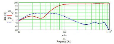

The "ported plot" was amplitude IIRC. To me, that's more important than the z curve. No good having a flat z if it only produces heat. I have resistors for that.

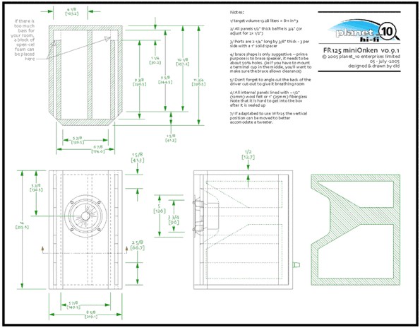

Hi guys, just a quick question.
As my first speaker project I have built a pair of FR125s Mini-Onken's.
I have stuffed some light foam just inside the internal opening of the vents indicated in the diagram.
I am very happy with the sound per £/$ performance. Lovely detailed bass from tiny drivers.
Does this mean that they are now Aperiodic chaps?
Lee.
