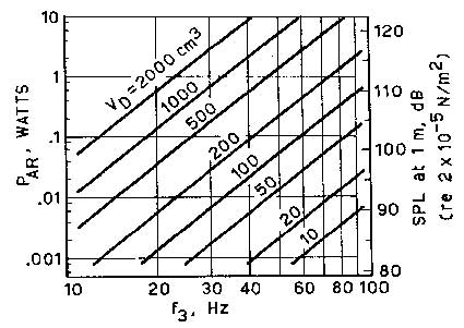

I've attached a chart that shows the volume displacement required for different bass frequencies to get different volumes. Work out how loud you want to play, and then read the number off the chart for 40Hz. Borrowing an SPL meter is a good idea.

The Beta's have weak motor assemblies and I don't think they'll supply the <i>snap</i> you're after. The Deltas are a bit better, the Pro ranges much better again, but more expensive.

No the chart is for the amount of air required to be moved at a certain frequency for a given SPL. It has nothing to do with the specific implementation of a given speaker. The chart applies to sealed or ported boxes, horns or monkeys waving fans.
So that 100 cc of air you are moving at 42 Hz becomes between 300 and 400 cc of air at 42 Hz when you port the box.
Again, no. See above.
Also, PA speakers are built with smaller linear excursions but have plenty of room outside the linear range. There will be sound compression and distortion, but at least extra is there when you have to "nail it".
For a bass when you want to slap, you need lots of clean transient ability, which translates to lots of clean excursion and displacement (in the lower ranges), and no compression or distortion. Compression and distortion are for guitarists.
The chart is very useful as long as you multiply the volume by 3 or 4 for the tuning frequency. Above the tuning frequency, the benefit gets progressively less until there is little left an octave above the tuning frequency. That's okay-the greatest need for excursion is the lowest octave-precisely where the greatest benefit of the ported system lies.
First sentence, no. See above. The chart can be extrapolated to find the volume displacement required to give a certain SPL at any frequency.

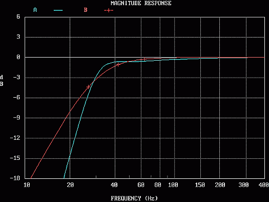

The following illustration shows two 10 inch speakers with equal midband SPL's, (87.8 dB@1Watt/1Meter) played at 100 watts each. The blue line is the ported speaker. The red line is a sealed speaker in a much larger enclosure. However, down to 30 Hz, the 3 dB down point for both, their responses are essentially identical.

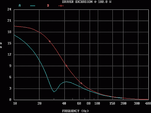

Now, however, let us examine the cone excursion for these two 10 inch speakers putting out essentially equal output throughout their passband. Remember, the light blue line is the ported speaker, the red line id the the sealed box speaker. Remarkable difference, any way you look at it.
diyAudio Moderator Emeritus
Joined 2001
As you can see, at 30 Hz-the 3 dB down point for both speakers-the ported speaker only has to move between 2 and 3 mm, while the sealed box speaker-with the same SPL output as the ported-has to move about 14 mm.
For what it is worth, I think this simulation program, BoxModel by Bullock and White, is slightly optimistic as regards the excursion saving for the ported. This imaginary woofer is essentially a modified Peerless CSX 10", and the Peerless CSX 10" will give similar results to this when placed in a 2 cubic foot box and tuned to 30 Hz. I think the excursion saving at Fb is usually closer to fourfold as opposed to sixfold in a 2 cubic foot box as this simulation program shows. But let us not quibble-the point is illustrated.
The larger the enclosure is, the less the excursion saving, but it is still substantial. For a 5 cu ft plus box like luisma's, he can count on at least a threefold advantage, but he might get more. All this is assuming the box is well-made and sealed.
His speaker will only have to move one third as much as a sealed speaker to produce the same SPL at the tuned frequency of the box, therefore luisma should multiply his speaker's air moving capacity by three to see how loud it plays at the box tuning frequency. If the chart says that 1,000 cc of air must be moved to produce a certain SPL, a speaker in a ported box must only move 333 cc to produce that SPL-assuming the frequency is near the tuned frequency of the box.

The volume displacement chart I posted, does not differentiate between method of generation, so it does not apply directly to a sealed box as you stated in your first post. In the band around resonance, the combined total of the port and driver will be the measure of performance in a ported box, no question. However, there is a decided difference in tonality between what comes directly from the driver, and what comes from the port. They don't sound alike and the tone will change a lot in that bottom octave. I've found this in almost every domestic ported box I've ever heard, that's why I won't own one any more.
From my experience with PA systems, a pair of 12" drivers with a Vd of 84cc, irrespective of what a port may add, will not be enough to overcome a drumkit in the nearfield. You need to move a LOT of air and clean.
