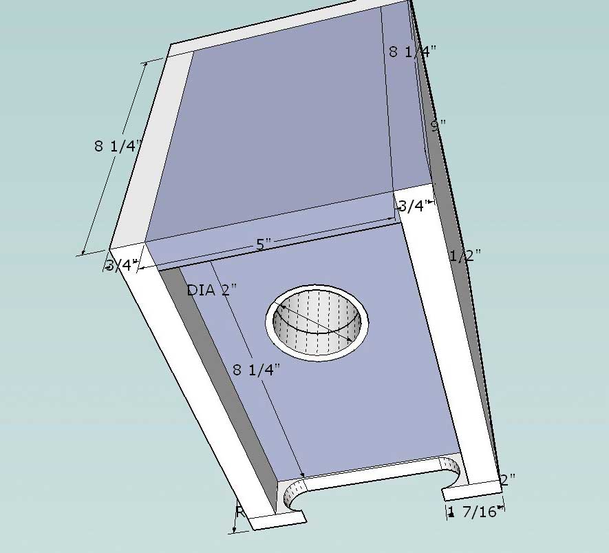

Delsol- inexpensive full range bookshelf.
Here's one I've been keeping under wraps, but it's time to share.
Use the Aura NS3-194-8E, on sale for $10.50 from Madisound.
http://www.madisound.com/cgi-bin/index.cgi?cart_id=1251650.9881&pid=1705
Ignore the fs, it does far better than the numbers indicate.
Especially in my box.
One half sheet of MDF (you might could squeeze it out of a quarter sheet, with no mistakes)
Some padding for the back wall ( felt or carpet pad)
2"dia PVC (you can play with the port size)
1/2"hardwood face, or use 1/2" MDF or birch ply if you have to, but it won't sound as good. Mine is maple.
I developed this for use with the t-amp, and have found it works very well with the higher powered amp6.
I present this as an experimental starting point, and welcome suggestions.
design goals were-
cheap,
simple,
audiophile sound,
no crossover, just a driver (mechanical mods only),
rock the party.
plans at -
http://www.flickr.com/photos/47642593@N00/295706737/
Just build 'em- I think you'll be glad you did.

question about the porting...
wondering if the pipe section can be replaced with a rectangular section of vent that runs up the inside of the back wall? You might even get away with just a slot in the bottom at the back edge. That way if you place a bottom on the cabinet you can stand mount the speaker and your vent still works. Is there a special interaction going on between the two vent sections in this design? As it stands the vent action will be modified depending on what kind of surface the speaker sits on (ie. smooth floor or carpeted). Comments? Regards Moray James.
I intended that these be set on a hard surface like a desktop or bookshelf, not the floor. It would be easy enough to incorporate a bottom for other uses.
You can do whatever you want with the vent, but
I already tried the slot idea, with inferior results. Vents along walls are generally a bad idea.

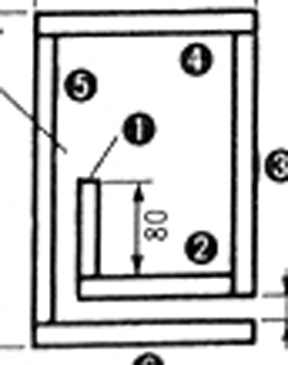

Slot vents tend to...
provide
a broader BW in terms of load as compared to round or square ducts.
Seemed simpler to construct with all rectangular vents and I can see no advantage to switching to a round tube duct (in keeping with the design goal of ease of build). You could stretch this into two ducts and have a mini Onken design. This would also provide some internal cabinet reinforcment. Regards Moray James.

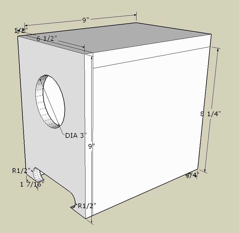

The attached pic. is similar to what I tried, and was unhappy with the result.
Your idea is interesting, reminds me of the Solo-103.
This box is really quite small, and with 3/4" walls needs no bracing, IMO.
Pekar

good picture....
yes that is what I had thought as it keeps things very simple with now round holes to cut or pipe to buy. What ever the tunning of the pipe you are using it can be matched this way without much effort. Dave Dlugos (PLANET 10) has a design for a mini Onken for a Fostex Fe127e on his site. While the tunning is lower than would be for your design the size is close and retunning the vents could be done to suit your driver. Though given the rather high Fs I am not sure there is really a lot of point to it as a sealed bos of not a lot of volume should attain the similar results but it is a nice design. Regards Moray James.
I don't find round ports especially inconvenient. I've done it with a 2" holesaw by butting the pvc to the hole and gluing it in place.
I did use a router to cut the 2 3/8" hole for the enclosure in the picture.
It depends on which tools are at hand.
When tipped on its side bass performance suffers.
I would also like to point out that this driver was designed by Ben Tang, and that it has a neodymium magnet.
Pekar
