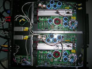

Hi Fredos, the new web-site looks nice. Changed I would make:
"Experiement the thrue power of Digital Amplification" should read : "Experience the true power for Class-D Amplification".
The problem I have with associating the word digital with Class-D is that there is nothing digital about Class-D amplification. You put analog in, and you get analog out, with no ADC or DAC stages inbetween. PWM and digital are two different things. There may be digital aspects to how the PWM signal is generated, but the amplification itself I don't beleive to be a digital process.
I would also change every place the word "Serie" is used on the product page to "Series". I just skimmed through the Sales and Support page, there is wording in bracets that reads: "based on the principle of PWM modulation". This would be an inproper use of the PWM acronym, and should be changed to "based on the principle of PWM" or "based on the principle of pulse width modulation".
I hope this helps with your web-site, and I must add that your 12,000 Watt amp in a 1U chassis is crazy! You must have some powerful fans in there, because even at 97% efficiency, 12000 Watts will still generate 360 Watts of heat at full output....The things I would do with 12000 Watts... ;)
Hello DcibeL
Dont forget that music is about 30% duty cycle of full power...Reduce your 360W by this and you got 110 Watts of heat...:) Add on this the lose in some IC, specialy the gate drivers and some linear regulator and you will get worst case 120 watts of heat for 2 channel...At full music power...And I can told you that for as now, nobody use it even near clipping...Thanks to BSS and DBX drive rack! Even in big rave, amplifier still cold after 12 hours of work!
Thanks for the hint on web page, please send me a mail!
