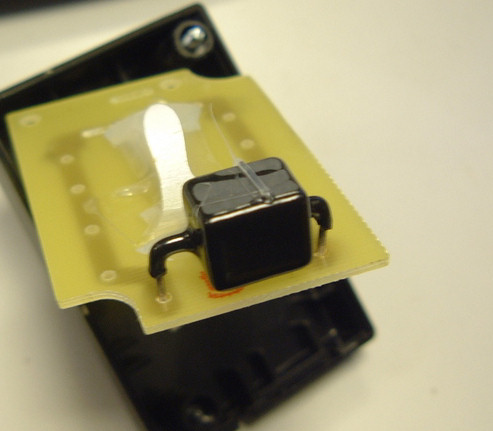

I have opened up an expensive mains surge protection device to see what was inside. I was expecting to see VDR , GAS and transient diodes.
But no! this was inside (see pic) and the surface has been filed off.
It looks like a ceramic transient device but I cant be sure, ive trawled the internet and cant find anything like it.
Its across L-N and no other components are on the pcb.
So any help on what it actually is and where I can get some from would be appreciated .

Electrically it measures open circuit both ways. And on a capacitance test measures roughly 1nF.
All surge devices measure open circuit and the go short or low ohm when a voltage is exeeded.
The component is fully encapsulated and I don't fancy trying to break it as a new one is £130

This info indicates that´s simply a MO varistor!

Russ Andrew says it does not deteriorate with age and is hundreds of times better than his super clamp which comprises a MOV and a Transient diode (SAD).
Here is a link
Mega Clamp
Brent

I have scratched away at the component and I dont think I can get into it, it appears to be made of a ferrit material.
Brent
I don't entirely think its to hide the cost.
Russ Andrews does a surge protection plug called 'Super Clamp Ultra' and this has 3 MOV and 3 Transient diodes across LN NE LE @ £55.
This must be something a little more special @ £130 and its only across LN. The 3 pole one is £255
Brent
