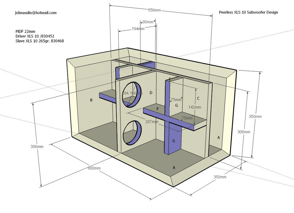

I'm wan't to build a subwoofer to complete the bottom of my Dynaudio BM 6 studio monitors. http://www.dynaudioacoustics.com/Default.asp?Id=275
I ordered a Peerless 10" with a passive slave 265grams to go in a front loaded cabinet. I don't wan't a booming sub, just a good frequence response to control the lowest part of the material I mix.
Got some discription from the internet and made a drawing. Can give me some clues if I'm going to get good results?

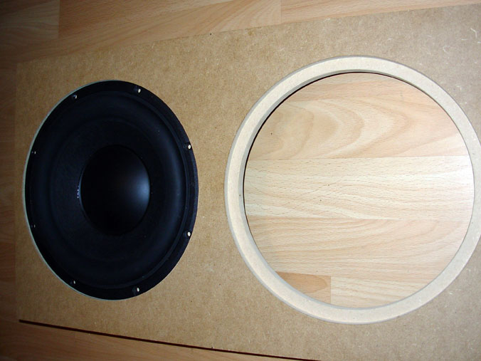

I used the standard guide that comes with the router, turned it up side down, and put it back in the router like u use it when you want to cut straight guided lines or edges. Mine has 2 holes in it, in line with the bit. I drilled a 4mm hole in the center of the speaker position and used a 5mm screw from the bottom center of the hole. As it comes out at the other end, you can place the little hole around it, and then adjust it exactly to get the desired diameter. It’s very accurate, the speaker just fit in, not able to move at all.

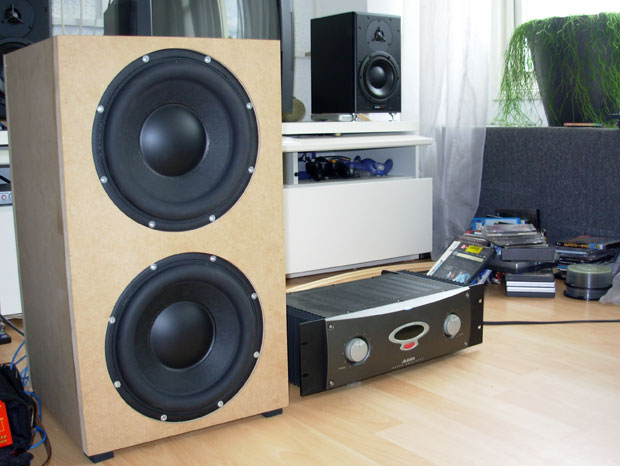

I have finished the cabinet, and doing some test right now, my first impression is amazing! It perfectly matches with the Dynaudio BM 6 speakers. For now I’m using an Alesis RA 500 amplifier directly connected to the sub out of my soundcard. Still don’t now what kind of amp I’m going to use; Thommessen Proteus SW2.5, Hypex DS 2.0. Suggestions are welcome.

I also do think the 2.0 will do just fine for my kind of purpose. So far the result of the design is awesome, much better then I had expected. I have listened to several so called high end subs, like Rell and Velodyne, but this is for sure what I was looking for! It’s smooth trough the whole frequency range, without any bumps like many home cinema subs have. The dynamic performance is excellent and it ads more then enough bottom combined with the small Dynaudio speakers without (very important for me) masking any detail in the low/low-mid range of the whole picture. This weekend I’m going to try it in a 5.1 setup, see what it does with some Star Wars and Top Gun. Next week I’ll run some serious test in the studio, because the building I live in didn’t like the gong drums from Toto’s – I Will Remember ;-)

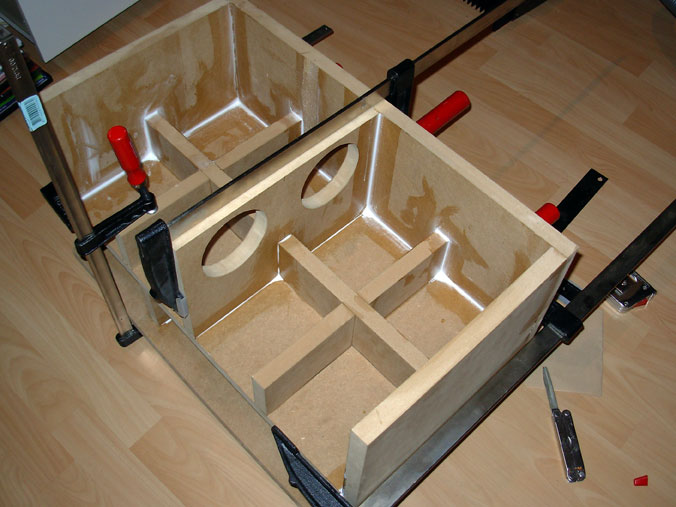

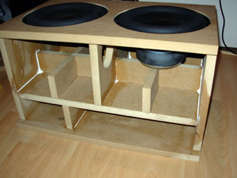

Do you own a 12” already? You might want to consider a 10” configuration. How big is your room and what is the distance from your speakers to you listening position? This sub is giving me much headroom, don’t think I will ever use it at full power. But if you already own a 12” you need to do some calculations on the design to get it suite the XLS-12. I’m using a 60 x 35 x 35cm cabinet made out of 22mm MDF. As you can see on the drawing, it takes some bracing to keep things from vibrating. If you need some numbers I can try to recalculate them for the XLS-12, but the cabinet is going to be bigger… Keep you posted.

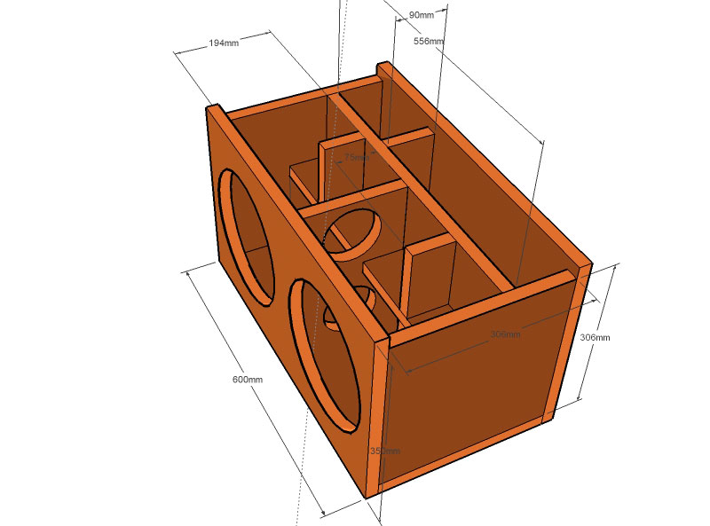

What I'm curious about, is the design. I see in both the drawings and the photo a 90mm x 306mm empty cavity in the box. What is it's purpose and can it be "deleted", allowing for smaller outer dimensions? The reason I ask is I'm also planning to build a decent sub with plenty dynamics and plenty deep bass extension without coloration. I also own Dynaudio speakers (Audience 122 + 122 Center) that lack a little punch in the low end and lack sub bass below 40Hz. This design looks rather appealing, but it's a bit too big for the small room I live in. I'm a former student, just graduated, still living in a small room, but in need of big sound...
If the 90mm x 306mm cavity can be deleted, the box can be kept 350mm x 350mm, but less than 600mm tall. Which would be perfect for my situation, dimension wise. But what about sound? Will it work in a 13m2 room, or is it too big? I plan to be using one of these two amps: RCM Detonation DT 150 or DT 300.
