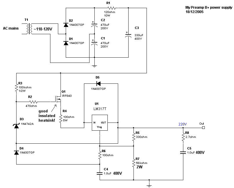

Alex, yes that's what I use to regulate B+ in my preamp. See details here: http://www.giaime.altervista.org/mypreamp.html
The original schematic is the Maida regulator, in a National application note: see here http://www.national.com/an/LB/LB-47.pdf

Thank you everyone !!! These projects are interesting indeed!
I may focus on the one using IRF840 as the MJE3439 is quite rare in Thailand.
However, here are questions :
(1) We can adjust the regulated volage by changing or choosing appropriate zener diodes Right? For example, using two 130V zener to regulate 260V?
(2) What is the adjustable range of voltage? For example, is it possible to regulate at 330V ?
(3) How many amperes can both circuits supply?
Thank you !!!!!!!!!!!!!
I can answer for what regards my circuit. Output voltage changes by changing the value of R7: note that you cannot put a trimmer (it will burn), you have to try different 2W resistors.
Current here isn't a problem, over 200-300mA probably can be supplyed, however the mosfet dissipation should be reasonable. Note that the less voltage is dropped by the regulator, the more current you can source from it. Don't drop less than 15-20V for regulation purposes.
