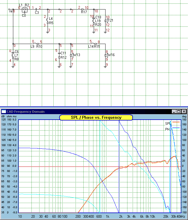

Here's what a passive ladder delay network looks like, at least as it's laid out in SoundEasy. Values L6, C8, C9 and L10 are the circuit. (everything else in this network is response shaping and impedance control)
I occasionally do these on LR2 designs with large woofers mounted on flat (non-tilted) baffles. It's a way to make up for the difference in acoustic centers. I've never published a design like that because of it's complexity and the tendency of people to look at the crossover and say "WTF is that?"

Are you saying the crossover schematic I posted will not work in the way I have intended it? I can provide acoustic measurements matching up with modeled plots in response and phase. I can show a measured very deep reverse null on the tweeter axis with a LR2 crossover, along with symmetrical vertical lobing which pretty much is not going to happen without a correctly operating ladder delay network.
You can just get your optimum values in the ladder by hitting your target slopes in the cad frequency domain, locking those values and optimizing only the ladder components. I pretty much just dump some average values in there and let the optimizer do it's job.

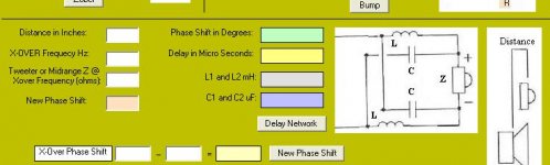

I mean that Soundeasy’s Lattice Network (which I have owned since it was SD1 and even before that and currently using V12) calculates the values based on ( Fo , Q , Rload ) it does not take into account phase shift at x-over frequency and x-over topology phase shift.
Yes you can use it as you said and by dumping some average values and then optimizing and coming up with values that are close enough ?
Here’s a screen shoot of basic program that I wrote years ago, which is based on totally different calculations. As you can see, all you have to do is input the actual distance, X-over frequency and Z at x-over and the values are calculated.

Yes, and yes. I'll post another image below, which shows the phase and response before and after the delay network. The red frequency response and blue phase are with the delay network. The orange and aqua curves are without it. I removed the circuit and grounded the components that went through L10. I get about a 90 degree change in phase wrap at 2kHz, which is what the optimizer determined I needed to put the drivers in phase at the crossover frequency.
