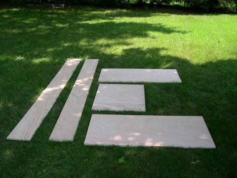

We had Lowe's do the major long cuts on the ply sheets for the side, front/top/back/bottom, and inner braces, which should save a little time at home. Some of the pieces are in the image, you are looking at 2 sides, an internal brace, and 9" strips for fronts and backs.

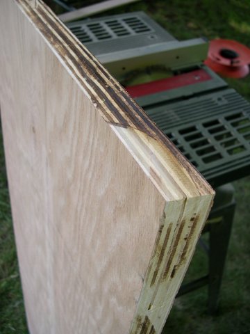

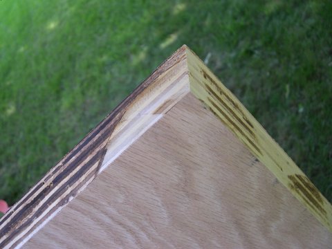

We (my dad and I) decided to join all the corners on a 45° angle, making nice sharp corners all around, so we ripped off all edges except those for the bottom. This will leave us with a nice oak to oak finish, hiding the ply. During this process we also started to match sides, choose fronts, and realize that with the 3/4" ply we probably will not need two internal cross braces.

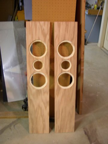

Layout Holes

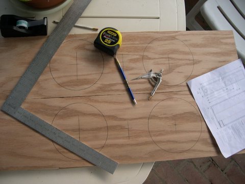

The next step after all the edges were cut down to 45° was to choose a pair of fronts and layout the speaker holes. We took the two that had the nicest grain and no filler, as opposed to picking the ugly ones I guess. Going to the Seas site and downloading the spec sheet for the speakers (links below) gave us the cut out dimensions, and using the plan we had the locations. Since we did not have a super accurate metric ruler we used the bisecting a line method from 9th grade geometry. Yeah baby, who says school was a waste? This gave us the radius to set the compass and off we went.

Cutout Holes
Not having large hole drills, we cut out the holes using a reciprocating saw after drilling starter holes. Taking it nice and slow produced good results, and a little sanding will make them pretty close to perfect. And, they will never be seen, so it is not 1000% critical. Having a large hole saw on a drill press would have been nice for this, but unless you are making lots of speakers, or have extra money laying around I was pretty happy with the results of this method.

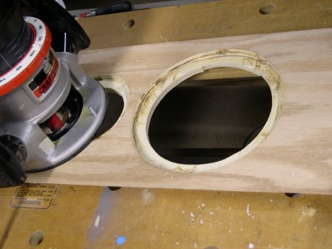

Route speaker recesses
After all six holes are cut out, the next step is to route the speaker recesses. This is where we are currently. Got through 2 holes before we burnt through his old bit. We have since bought a shiny new carbide bit, but I haven't made it back over there to continue. Here is the first two cut outs. We talked about making templates, but only doing 4 holes of one size, and 2 of the other we decided it wasn't worth it. Were I making any more than 1 pair I would say make templates for routing, totally worth it. Otherwise it just takes a lot of patience and concentration. Oh, and don't sneeze.:xfingers:
I will now admit the first f'up of the process much to my embarrassment, but I hope it will save someone else the same. When you are test fitting the drivers in your recesses to check the depth - remove the shipping supports from the driver screw holes. They stick down and will prop the driver up too much. Sounds simple, but it wasn't until we got part way through the deepening of the recess that we both smacked ourselves in the head. No worries, it’s an easy fix; we will use a ring of wood (or several) to prop up the driver in that one recess. So there’s a tip that is worth the price of admission.

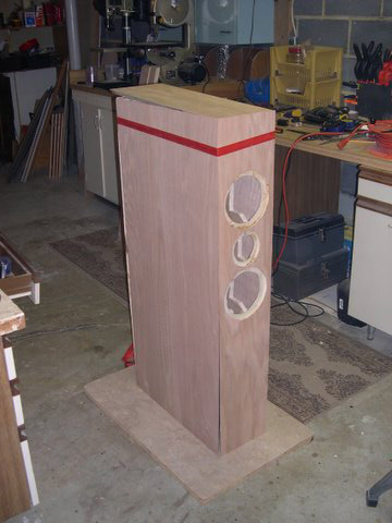

Short Thor
I finished the short Thor's and you will love them. I was lucky and found a specialty "hardwood" lumber company here in town. I used solid Red Oak to make my Thors............ overall they turned out very well. Spend the extra time to do the bracing, it's worth it!

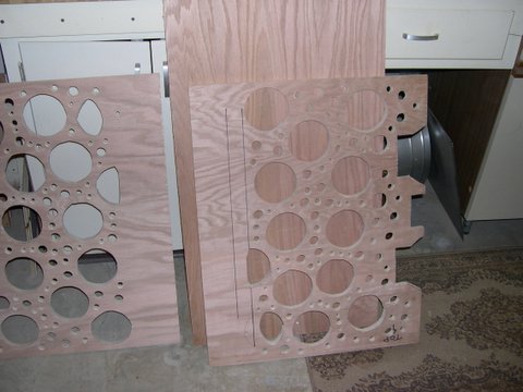

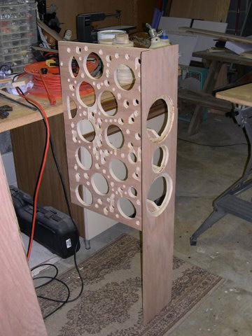

After the fronts were cut out we decided the next step was the front-back braces. So we made a rough template and cut them out. This image is a brace leaning against a side panel. I tried to get all fancy figuring out if we had taken out enough material. Trying to estimate surface area removed. That is silly. Much easier would be to weigh the panel before and during drilling. Reduce the weight by 35-50% and you have hit your target. Note that the panel is too long to fit inside the speaker, and will be trimmed to fit later, hence holes don't go all the way to the back.

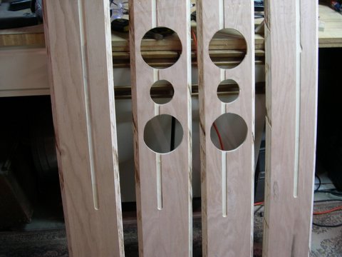

We made the decision to route a groove in the front, back and top for the main brace. This would provide more glue area and hopefully tie everything together better. This image is a set of fronts and backs grooved. Also note that the brace is not centered, as per the design.

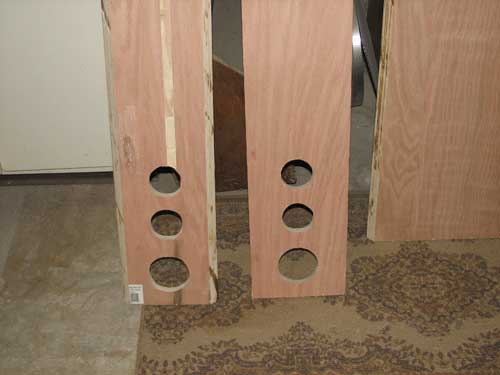

The next step after all the grooves were routed, brace holes sanded, and cutting the internal braces to length was to glue the brace to the front. We used our excellent brace gluing jig, aka some clamps and a carpenters square to make sure it was perpendicular.
After gluing both here is what you get. A front panel with a brace. You can see the damage done to the ply when it was drilled through. In places where several holes are close 1-2 layers was lost. All this was sanded to remove burrs and loose debris. The size of the speaker started to become aparent for the first time at this stage. These are going to be rather large. :D

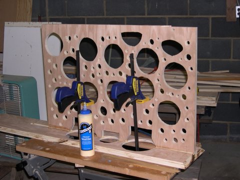

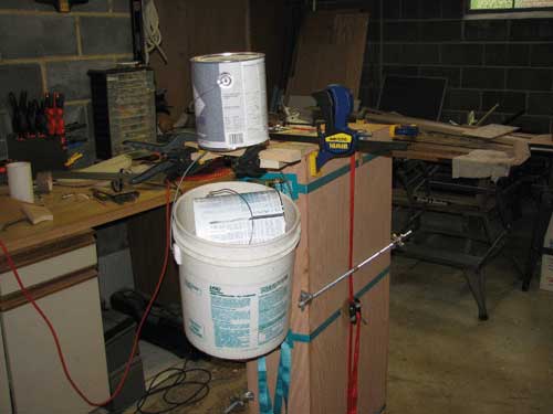

Fancy clamping system. This is the bucket lever 9000, availabe at your better hardware stores. Now we wait for the glue to dry on this one, and the second will be glued hopefully tomorrow. At that point it will be time to start the soldering of the crossover, and the finishing of the boxes.
