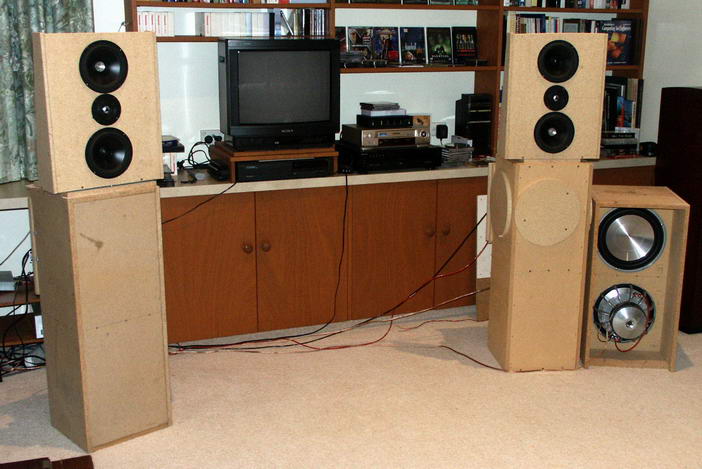

Well, I finally tried a fully open baffle setup, and the results have me puzzled. Firstly, I'll say I'm impressed. After a number of hours of listening, and watching King Kong, I notice the following:
* much bigger sweet spot
* midrange is more transparent
* bass is more accurate than I thought my drivers were capable of, most noticeable is that it is subjectively much more "quick" and it makes me aware of how much was added to the sound. In particular I notice this on things like kick drum - very convincing as if it is actually in the room - previously bass sounded exaggerated, but not due to frequency response
Before:
TL mains with Vifa P17 in MTM with two push pull sealed AV12 subs in the corner, EQ'd flat with Ultracurve (including room modes which aren't that bad in this room)
After:
The same drivers placed on 400mm wide x 500 tall main panels with 50 - 150mm wings and subs push pull H frame approx 400mm wide and deep

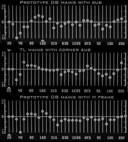

I notice the tonal balance doesn't sound the same, though the response is calibrated flat. The bass sounds more lean and quick, also the midrange does as well. I put this down to box coloration, and perhaps time domain performance.
Now here's the mystery:
The EQ required to compensate for dipole roll-off is ALMOST non existant!
Here are the settings used by Ultracurve to calibrate it flat. The response in the middle shows the "before", on the top a monopole sub is used and on the bottom is the full OB setup. Note, this is the EQ settings, so the actual response is close to the inverse.
Around 35 Hz there is a room mode peak which is EQ'd out in all of them.
So my question to OB gurus:
How do you explain the absence of EQ required? The main panel should have an fequal around 200 Hz, and similar for the H frame.
Another Q:
When calculating Fequal for a H frame, should D be taken as merely half the depth, or should I add half the baffle width?

As you can see, the construction quality and finish is outstanding! ... 5kg weights keep them from falling, and I'm using my existing passive 2.5 way crossovers
Also as you can see, those panels were precisely calculated for target fequal after hundreds of hours of research, simulation and testing ... *coughs* ... well, actually they were what I had lying around ...

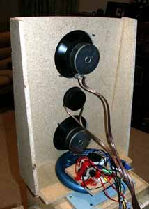

Ashok,
You might want to also have a go at the Vifa P17 tweak which I'm in the process of doing. It involves putting glue rings on the back of the cone and adding a phase plug. I've seen documentation for this and the improved frequency and time domain performance. I haven't had a chance for a proper AB comparison, but there does seem to be some improvement. I wrote about this in another thread I started recently.
I'm using my existing 2.5 way xo which is 2nd order and xo @ 3.5k. Ideally this is a bit high WRT off axis lobing but it's good for distortion and power handling. The 0.5 midbass has a first order LP @ 200 Hz.
You could try a 2.5 way where you have WMTMW. I'd try this where the outer woofers have a first order LP. This way you won't have the off axis lobing problem. I'd go with the ring radiator and experiment with a small waveguide to allow it to go a bit lower and take some strain off as they say it tends to want a 3rd order xo higher up than most would prefer to use.
Regarding baffle width, I did come across some guys who measured different widths compared to Linkwitz Phoenix design. Apparently its a trade off between lowering Fequal and polar response. If I stick with OB and make some decent ones then they won't be as wide.
I've been thinking of putting a small H or U frame below each main panel, or I could put the main panels on stands. I might also experiment with a corner dipole woofer.
Next I want to try:
* U frame woofer
* waveguides on the main panels, similar to Zaph's
Next I want to try:
* U frame woofer
Hi Paul,paulspencer said:That would mean the TL/subwoofer setup would show room gain, yet it doesn't!
What confuses things more is that dipoles are meant to couple differently to room modes and gain as I recall ...
I'm curious, too. What are your room dimensions?
My under-informed guess is that the dipole behavior causes the room to behave differently.
I'm hoping to see an informed guess...
Dave
Looks like you did unintentionally what I did intentionnally in my dipoles ... using the various acoustic rolloffs and gains to compensate each other.
If you read the Linkwitz site you'll find that he uses a shelving highpass from 100 to 200 Hz to compensate for 6 dB gain as you move towards the lower frequencies (floor reflection adds increasingly in-phase to direct sound) . In your case and with an fequal of 200 Hz, leaving the floor gain uncorrected means your dipole rolloff is automatically "compensated" down to 100 Hz.
Below that, you might either have a mixture of room effects, or a high Q woofer, producing additional gain. Even with dipoles, you do get room effects. For instance, I have resonances at 25 Hz and multiples thereof up to 125 Hz in my ordinary sized - but asymmetrical - room. The largest peak (around 100 Hz) is easily +6 dB. So, in your case just one broad +6 dB peak say centered at 60 Hz with -3dB at 40 and 80 Hz may be responsible for giving you an EQ-free zone down to practically 40 Hz ...
Or so the story might go.

The reason I asked about the distances to the rear, was to determine if the back wave is being diffused or absorbed. If so this will create a less than ideal dipole response by ideal I mean a perfect figure 8 response and the "normal" low end cancellations/rolloff. You are not alone in this, someonelse put a woofer in a room at an angle and did not get the usual rolloff.I would like to know EXACTLY what is going on, but for now I will accept that there are unaccounted for factors boosting already.
Im not saying this is the reason, Im merely speculating based on thought experiments that have been loosely confirmed by two people.
To test it either remove the table/shelving and retest the FR or move the speakers to a different wall/room, if you care anyways.
I have built 2 OB speakers, and found that the required EQ was less than indicated by a simple 6 db per octave.
However, since TL has posted this information on several threads, I was trying to keep my baffle width @ about 20" to minimize my EQ.
TL has a calculator on his web site that better predicts this than anything else I have seen.
My test OB have usable base below 40, with only 3 db of EQ.
My Version 2 OB needs 6 db of EQ, but the drivers are much lower Q.
