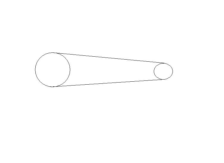

look at the pic ...:)
the small wheel is turning the big wheel ,when a chain is connecting between them .
if the small wheel is turning at constant speed , no friction whatsoever ...
is there a force on the chain?

but , i forgot :rolleyes: ,there must be a static friction between the chain and the wheels , if not then the chain wont move :eek:
There has to be a force on the chain. If there was no force, the momentum of the links that are going straight would keep them going straight. But as you illustrated, they go around the sprockets. The centripetal acceleration of the links makes chain want to come off the sprocket as it goes around. The chain, being a loop, prevents this because the other side of the chain going around the other sprocket wants to come off in the opposite direction. All this results in tension in the chain.
If the chain was a perfect circle, then there would be no force on it.

When you say "tension in the chain"... where exactly in the chain are you talking about?
There is no net work being done... that doesn't mean there isn't tension somewhere.
If you replace the chain with a railroad track and put cars on it, and then set the cars in motion (I'm assuming the cars are following the track), then the cars will fly off the track as the track starts to curve around the sprocket. You never said to set the track in motion too, so I assumed that was stationary. ;)
Now let's say that you mount the cars to the track, and set the whole thing in motion, then the cars will want to pull the track (chain) off the sprockets due to centripetal acceleration. The track (chain) is designed to not come apart, therefore, the cars will produce tension in the track (chain). The straight parts of the chain, connecting both sprockets, will have tension in them too, because the two parts of the chain, around the sprockets, are trying to separate from each other.
