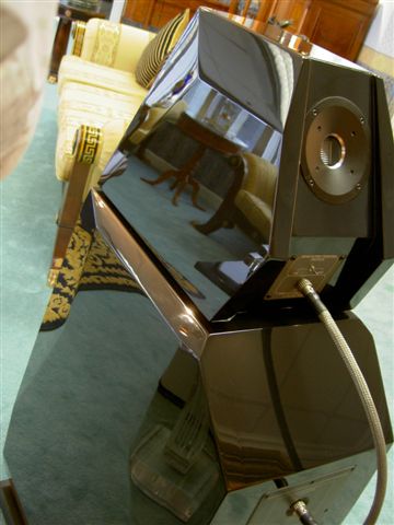

Its a lot of work to get a high gloss finish but the results are very pleasing to the eye. I'm in the process of doing a piano black:

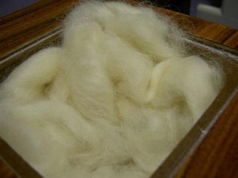

The location where I living is at least 6 to 10 hours time difference between all you guys' country, so when I online you must be sleeping.
Back to your question, the wool I'm using is a kind of industrial raw material directly from New Zealand, like the picture shown below.
The cabinet is made of 4 different thickness layers---2 HDF, 1 MDF, 1 plywood.
That's a little hard to explain. I can only say that the accurate worked, fine polished and dust-disposal roughcast is crucially, a dust-free painting room is also a key point to the goal.

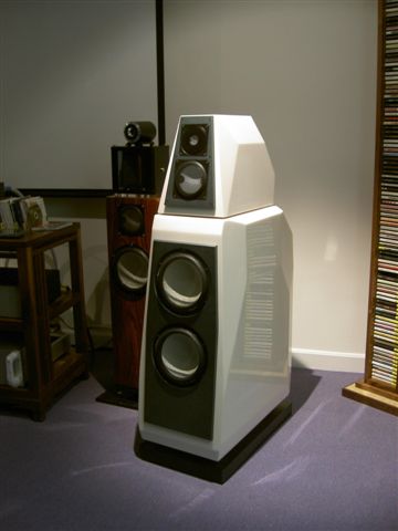

The Marten Design Coltrane is using a diamond tweeter, ours is a T224 special version. In my view, I found that the diamond is very good but a little bit overprice, C224 is the best choice considering.
You are right, x-over is the most important part especially for the Accuton units.
38 pcs aluminium components are 38 different functions and sizes aluminum parts, some of them are over 2 feet long and 12 mm thickness.
My email: glen_info@yahoo.com.hk
It depends on different case. In this case, inverted polarity.

Yep agreed, I only refer to it as piano black on occasion. Its really just a high gloss 2pack automotive finish. The results are arguably just as beautiful though and, as always, its difficult to get a photo that does justice to the real thing.
The other essential difference here is that I did all that by hand rather than in a dedicated production facility. Not bad at all considering it rivals proffessional finishes and was done in the garage during my spare time. :)

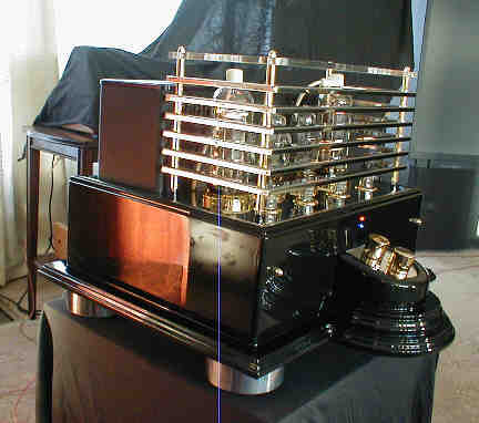

Fung,
Welcome out of hiding. Your speaker design looks very elegant and the finish detail is superb. I have some appreciation to the effort going into hand application of a nice piano black finish. The only time I have done this is shown here. This is my one-of, massively redesigned MingDa 300B driving 805 SET amp. The custom case is hard maple and has 18 coats of hand rubbed lacquer. I would not have the patience, or stamina in my aging hands to do large cabinet surfaces in this manner. I made this amp two years ago and it is my pride and joy.
I wish you best on your own brand speaker business venture. What is the efficiency rating in dB/watt/1 metre?
