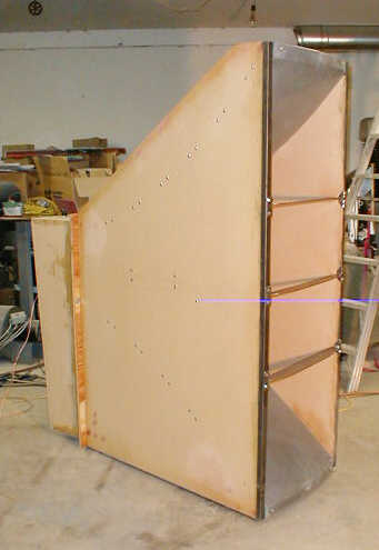

I have a large finished recreation room downstairs which is the full length by half the width of the house. I placed a 6x8 foot screen on one end and built a large set of custom fitted 50 Hz front horns, one on each side. I lost my pictures in a HD crash so cannot show just now. The horns are front loaded Selenium 12CO1P coaxials with a total cabinet depth of 5 feet. Horn mouth is 28" and height is as close to the ceiling as possible, about 7 feet. I was inspired by someone who posted on the web how he had sawn an Altec 210 VOT cabinet basically in two halves. I can appreciate what you are attempting to do! :D
Miraculously I was able to recover my pictures recently off that old pooched HD. Here is a picture of one of my large front horns as it was almost at the stage of completion. I don't want to steal any thinder here so I'll perhaps set up another thread with pics and post a link here.
