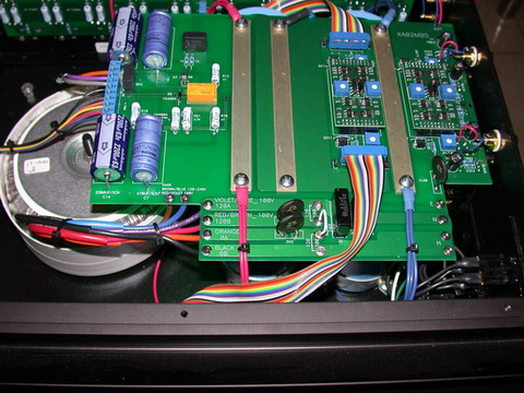

Pass X250 concept ?
I seen UGS4 module on PASS X250, does it as same as UGS2,3 module in PASS X2 ?
I think it's cascode jfet+transistor and drive with little mosfet (zvn\zvp) but I don't understand how to use zvn/zvp stage to drive power mosfet by use irfdxxxx for vbe bias in balanced aplication.
I want to apply this module for input stage of AYRE V3 PROTO is it posible ?
Please me Mr.PASS (only simplify)
