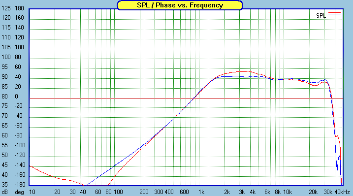

Well, I once took a D26NC55, removed the flange and put a custom 1/2" waveguide on it. Results shown below. It put a mild boost centered at 3.5khz. It worked well to raise output in that area when used with a narrow cabinet that had a diffraction related dip there.

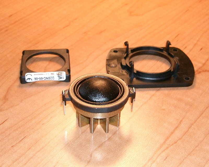

AJinFLA said:
When you say removed, do you mean cut it off, or is the faceplate actually removable?
AJ
Removed it. See image below. The dome/coil assembly also pops off and is replaceable.
The remaining assembly was press fit into a board that had a 1-5/16" hole with a 1/2" routered roundover. No complex shape or anything, just a 90 degree arc with a .5" radius. I've come to the conclusion this is a prefered way to mount this tweeter, and it sure beats the hell out of countersinking that odd flange shape.
