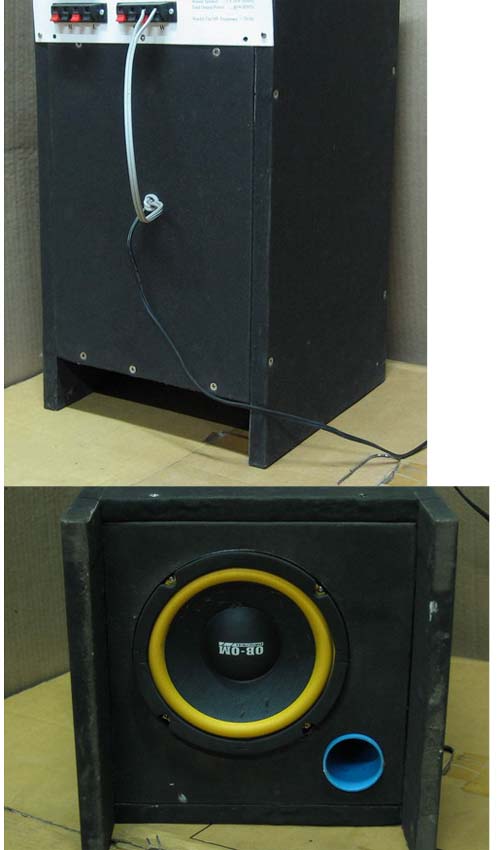

Hello Friend,
I already designed 5.1 amplifier, satellite spk & sub woofer.
6" 8ohm woofer spk.
You can see in http://gigaamp.com
But i didn't satisfy that.
Woofer amp power is small.
So, I designed bridge/parallel amp with tda2030.( from national )
( Old one is designed in bridge. )
And then I put another 6" 8ohm woofer spk.
Two spk join in out of phase in parallel.
I screwed two spk front to front.
But woofer sound is no good at all.( more disappoint ).
I reduce or increase the pipe of the port ( try-and-error ).
One spk is better than two spk.
Pls, help me for subwoofer design.
sorry for my poor english.
How can I calculate my design?
How can I design my subwoofer?
what you did is called an isobarik configuration. When you mount to woofers together like this (front to front) the Vas is reduced by one half, and the box needs to be half the size and the port needs to be more than twice the length, or maybe a smaller port.
If you have the T/S parameters of the woofers then I could give you an idea of what port to use, the box needs to be half size though.
Using the same port or shorter will raise the tuning resulting in a huge resonant peak, making it sound like the sub only produces one bass note instead of the whole bass spectrum.
Hope this helps a little
BTW winisd is free to download and will help you in designing woofer enclosures.

Hi nunayafb,
You said box size reduce 1/2 & pipe length increase 2.1 times.
Box size reduce when pipe length increase. ( in my woofer ).
Is that right?
Need to calculate pipe volume in the woofer?
Box size will not reduce 1/2 if pipe volume need to calculate.
Box size will reduce under 1/2.
In my subwoofer,
Can I need to calculate bottom of the box volume (between spk & ground)?
Pls, reply me.
Thanks.
I am pretty sure you do not need to worry about the volume of the port, I have never heard anyone mention that before. No time right now but tonight I'll check my book and make sure.
I just noticed in the photo that the woofer fires down, are you going to have enough room for isobarik, or are you going to raise the box up?

If you have a box of 1/2 the size, the port need to be 2 times longer. Smaller box = longer port.
You don't calculate the volume under the box.
1.5cm left between spk back & ground.
Same thaught.
Will it be OK, if i only increase the lenght of my pipe?
Not reduce of my box.
Is air flow in pipe effected when the pipe is bent?
Because my pipe is nearly Long to the spk height.
Not sure, youll have to try it, winisd does not let you change port lengths independently.
Yes, but... the losses due to bent pipes are alot less than the problems associated with the port end being to close to the wall of the enclosure. You are entering a trial and error phase. You are going to have to try several ports that are about 1.5x to 1.8x the original, to avoid proximity to the wall and sitll increase the length enough for flat enough frequency response you are not going to get a perfect response when using the wrong box size and the wrong port length. Try a longer port only see if you like the sound.
remember, you wont gain dB's with isobarik only reduce distortion.(except for the 4ohm load now instead of 8ohm which will double power consumption giving you +3dB),
The main benefit of isob. is a smaller box... you might want to cut another hole in the box for the second woofer, on the back or side to corner or wall load it. Modeling in winisd show the f3 being increased by the addition of a second woofer with no port or box alterations(other than the permanent hole in the box). two woofers in parrallel should give you about 6dB boost as well. 3 from doubling cone area and 3 from doubling power.
good luck!

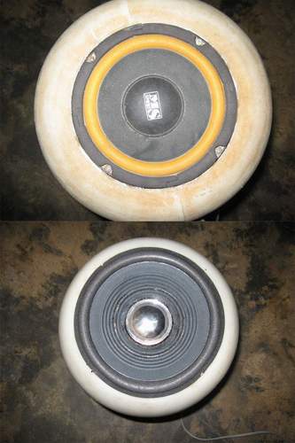

Hello friend,
I disappointed to design isobarik.
Because hard to design in my box.
In my box include power supply for my amps.
So cannot long & bent enough for pipe.
Now, I design new with cylinder plastic box ( pure drinking water box in my country ).
Design passive radiator configuration.
one side attached with 6" spk & other side attached with 8" cone.
(not include spk frame & spider).
Now, my subwoofer not bad for listen.
But it can get little rumbling sound.
New passive radiator cannot compare my (6" half transmission & half seal design.)
passive radiator can get low freq when increase mass of passive radiator.
Is that true?
reduce so many bass of song & a very little increase rumbling sound when I increase mass of cone.
How can i tune that box for not many reduce bass of song & increase so many rumbling sound?
Pls, Help Me.
Well, usually you need to use T/S parameters to design an enclosure with a passive radiator. Doing it by trial and error is not easy.
Yes if you add more weight to the passive, it will tune the box lower.
The problem is you must not overweight the passive cone or the cone surround will destroy itself.
Hello Friend,
Is that more good for rumbling freq & reduce destroy itself, if i used 10"cone?
In my photo
upper is 6"driver & lower is 8"passive radiator.
I want to put 5.1 channel amp int my that box.
So, reduce the volume of that box.
Will Frequency of my woofer be increase or decrease when I put amplifiers & powersupply in that box?

Hello friend,
I already tested with 10"passive radiator.
No good.
Sound is liked two speaker phase out.
I already tested with mass & without mass.
No good too.
How can I tune it?
For 8"passive radiator
Sound is good.
But resonace in some frequency.(some bass is more than normal
& over)
How can I tune it?
Pls help me.
