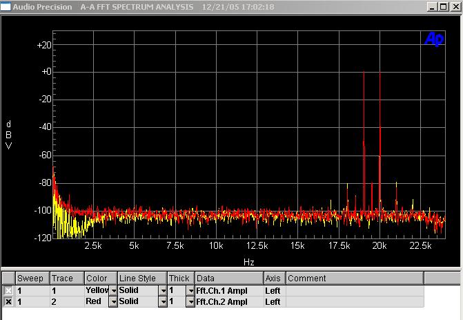

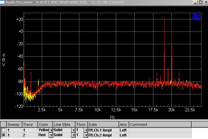

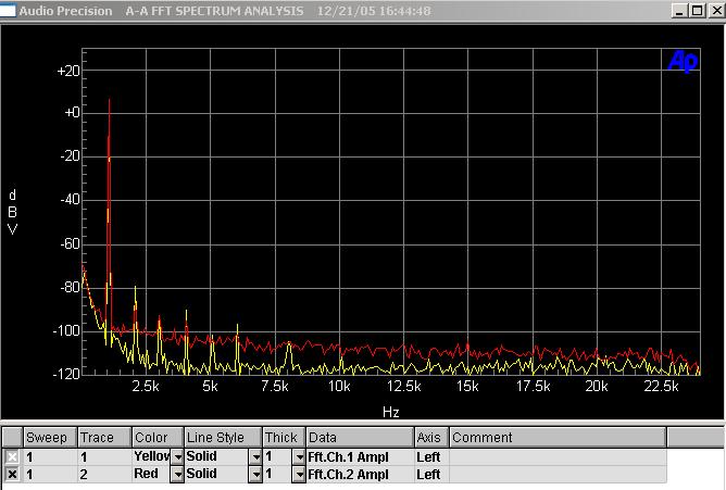

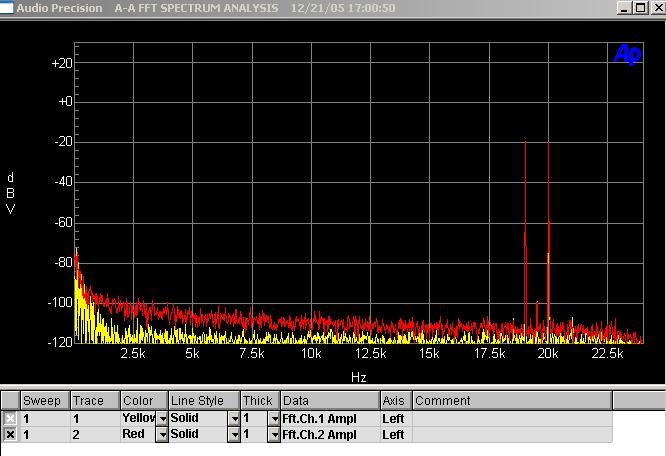

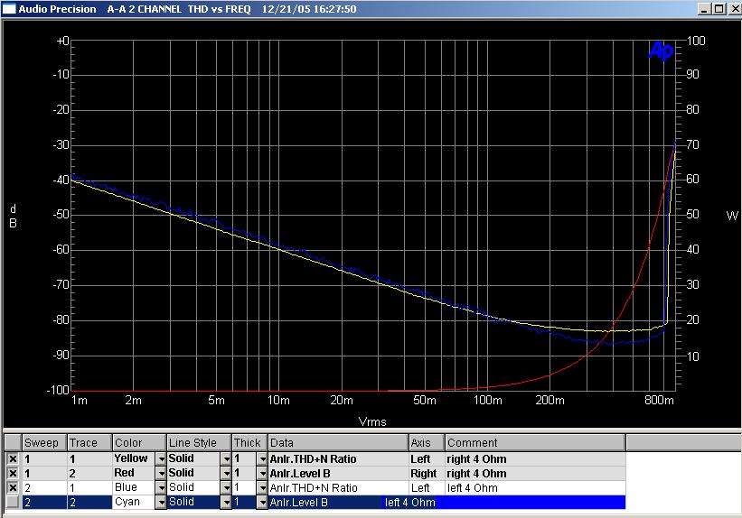

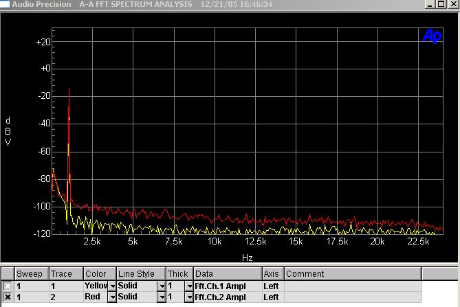

Thd+n
Here is THD+N and output power for both channels driven. Don’t pay attention to the slope (low frequency noise), have a look on THD prior clipping point.
all these mesasurements were done with my good old APT...

Looking at the APT -20db FFT, looks like a few PS artefacts there, but then the floor is quite low.
A schematic would be good?
