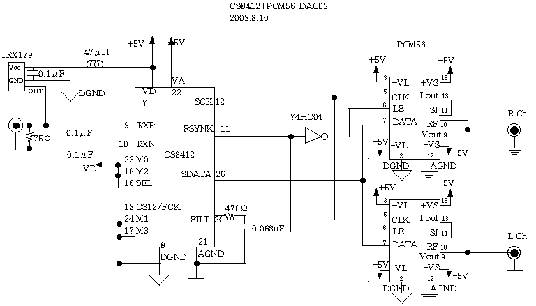

Hi Guys,
If i use this schematic and use a Pcm63 instead of Pcm56 will it works?
And then is it non-oversampling right?
Something like peter van willenswaard?
Thnx Maarten

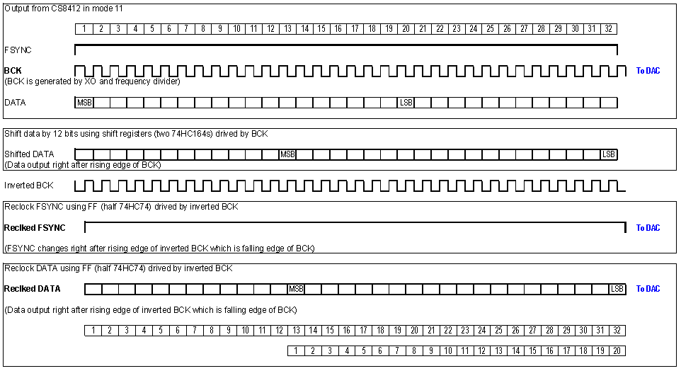

I am working with the prototype and having a strange problem.
I use a half of 74hc74 to reclock FSYNC. Clock frequency is 2.8224mhz. Left chanel work flawlessly. Then I use Q_bar output from this 74hc74 for right chanel LE. There is some repeated static noise on the right chanel. Music on the righ chanel is still very clear. I can't understand this. I know that Q_bar may be delayed slightly compared to Q but it shouldn't be that much to cause a problem.
I post the schematic below. Hopefully someone can help me.
Do I need a faster logic chip? The one I use is SN74HC74 branded TI
  • receiver.pdf
I have soldered the 74hc74 directly to the PCB. The result is the same i.e. still got noise. Aslo I have tried to feed the right channel PCM63 with LE of for left channel; the pcm63 of right channel process this signal perfectly. Definitely there is something wrong with the LE for right channel.
LE for left channel if Q from 74hc74 and LE for right channel is Q_bar from the same chip.
Perhaps I will try to reclock Fsync with higher clock rate e.g. 11.2896mhz.
