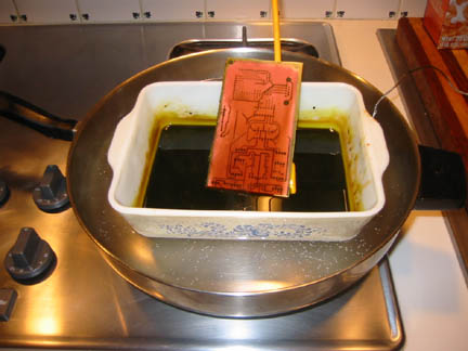

yes, my wife's good extra large Farberware frypan is used as a water bath to heat the FeCl to about 145 degrees. The etchant is in a Corning Wear dish, and as you can see, repeated uses have turned it a brownish yellow. I use a darkroom spatula/stirrer to rock the board. This method only takes a few minutes. After the board is cooked I wash it thoroughly, remove the protective ink with MEK (outdoors of course), clean it again with a rough cloth in running water, and give it a dip in LiquidTin:

jackinnj said:yes, my wife's good extra large Farberware frypan is used as a water bath to heat the FeCl to about 145 degrees. The etchant is in a Corning Wear dish, and as you can see, repeated uses have turned it a brownish yellow.
I am putting you on my list of people from whom I will NEVER accept a dinner invitation...
MR
Back when I was etching boards I used to use a plastic tank. I used an aquarium heater to get the temperature up a little, and an aquarium air pump and stone to bubble air through the liquid. The air does the agitating so I got nice, evenly etched boards and I didn't have to stand around watching the thing and agitating it for what always seems like hours (a watched pot never boils, as they say).
