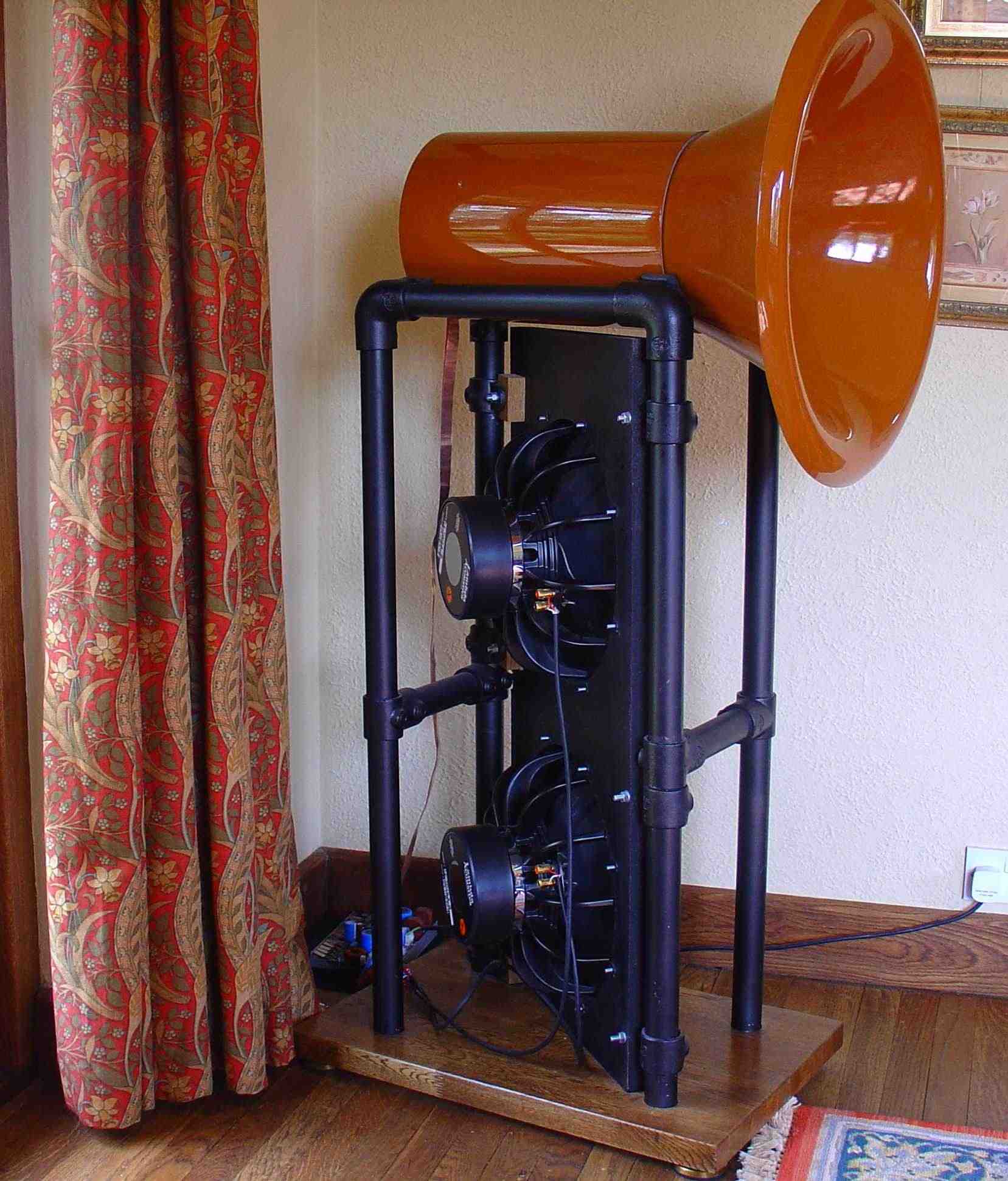

Yep, and very good they are too!
See:
http://www.kingdom.uk.com/jdfiles/side_open_right_full.jpg
http://www.kingdom.uk.com/jdfiles/in_room_close_full1.jpg
They dipoles are high passed at 160hz, and are pretyy flat to 30hz, rolling off rapidly after that.
I did try the final piece of baffle into the corner as per LS diagram, but to be honest it didn't really add anything.
The only other issue I would say, is that you have a failrly small room, and you may well have problems with a dipole mid, especially if they are used tight into the corners. I much favour the directive mid/high's as provided by the front horn than a dipole mid.

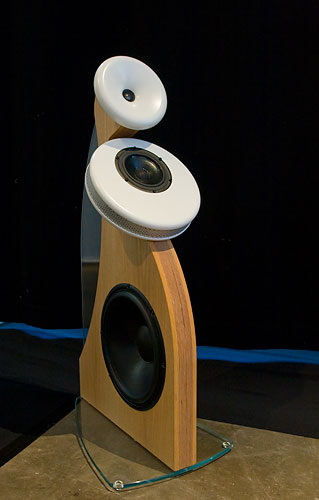

Reanimating a very old thread (but the only one related to the issue imho).
There is a new contender for the most ingenious dipole concept:
More info and pictures on the Gradient Helsinki website
Some speculations regarding this alien speaker have already started at audioasylum

Its seems still that I am one of the few to actually have tried these. I've been really happy with my set up for a couple of years.
Come on guys give it a go, it doesn't take much. Don't just wait to read about others trying these things, give it a go yourself!
Jonathan

I just can't see any point/benefit in putting a dipole in the corner. Even less the double system. Yes, the walls amplify sound, but it still has dipole loss towards lower frequencies. With smaller wavelengths summation gets messed with reflections and response starts to look like the edge of a saw, with phase variations... Easily the strongest, reflected but amplified impulse is late in time domain and in wrong polarity which causes a deep dips in response. Reversing polarity of wires doesn't help because this frequency does not match with xo nor timing.
Gradient Helsinki or similar along the sidewall out of corner works better perhaps, but is very critical for placement, angle and distance to wall
