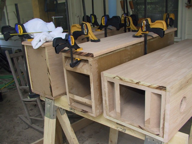

Pictures of my Thor project
Retired diyAudio Moderator
Joined 2002
in various stages..

I guess so... I made all of the external cuts longer then necessary, and they came out looking great with the belt sander.
I have a couple of questions about Thor:
a) will spikes help the sound of the speaker? I have seen no finished Thor TL speakers that used spikes.
b) will the extra .5" on each side of the front baffle change the sound of the speaker that much? I read about baffle sound frequency, but will the sound difference be noticible?
c) anyone have any tips on finishing red oak?
This is my first speaker project, and first time since early high school, since I have worked with wood.
Brian
I am surprised it's coming so fast. I t looks good too.
I noticed you will have some closed cavities inside the box, you might consider filling them with sand. As to the spikes, or any sort of legs you'll have to decide for yourself by listening tests, because it also depends on the floor the speaker is standing on.
I wouldn't worry about .5" of a difference in size.
I'm not much expert on finishing the oak, but you might use some sort of stain and maybe water based laquer. Maybe the experts at your local Home Depot could shed some advice.;)
Joined 2002
There actually will only be two small closed cavities, which are created on the bottom where the 45 degree angles used in the transmission are. I was thinking of filling them full of something, but I have not decided yet what to fill them with. The bottom part has inserts to make it easily to screw on and off, to adjust the stuffing. I have read that Thor will take quite a bit of adjusting the stuffing to get it to sound optimal. The crossover goes in the base, and I will mount the jacks to the base as well. (my friends are mounting his jacks to the back of the speaker, not the base). I have two weekends working on thor so far... basically 4 - 12hr days, and I am quite satisified with the progress so far. Basically now, I am held back a bit by the lack of clamps and waiting for glue to dry. (have one set of 6 clamps for gluing my speakers, and two friends have their own). My two friends started a week before me, so I was follow their lead, getting it done pretty quickly.
For finishing, I picked up a bucket of red oak stain and polyurethane. I am planning on getting them sanded down with 220 grit paper, cleaning off, and staining, then moving on the polyurethane, applying many coats.
They are quite heavy. The unfinished speaker (mdf covered in the red oak) weighs 70lbs without the base and speaker components installed components. I imagine that they will weigh in around 100lbs each after making a heavy base and finishing.
Brian

Peter, I had access to a router, and routed the outside oak part, but forgot to route the inside of the speaker opening, and I will spend some time sanding smooth and rounding with 60grit paper. It is just mdf, so it should sand easily away.
If you look at the second picture, you will see that the outside edges were rounded, and the speaker mounting place is set in with a router.

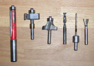

I was struck by your comment of using belt sander to make front flush with the sides. Here are some of my favourite bits. The first one is perfect for above task, second is good if you have to trim the inside of the driver opening, third for making round edges, forth for cutting round holes for drivers (I drill the center hole in the piece, measure the radius, insert the drill in the table and rotate the piece, cutting out the circle), next one is not that stiff so I use it for thin materials. last one is good for trimming inside of the cutout. Router is the most usefull tool for woodworking (especially if it's mounted on a table).
