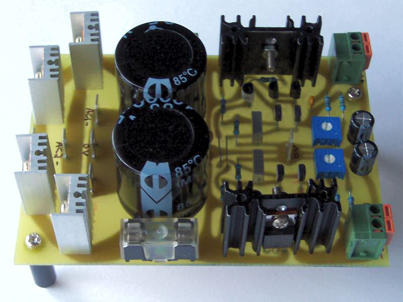

Finished capacitance multiplier
I've completed the capacitance multiplier first proposed in a previous thread. The final design is pretty much the same as the original. It's intended to supply the output stage of the subwoofer amplifier I'm currently working on.
Information and pictures concerning the capacitance multiplier can be found on my website.
Additionally, there is a simple regulated supply to go with it, also described on my website.
It works rather well. It's certainly tougher than my poor abused dummy load resistors:hot:
For those too lazy to click a link I've attached a photo of it to this post.

Am I really evil? Opinions differ. Some would say yes, some would think it impossible ;)
The usual, simple capacitance multiplier has no global feedback. It's not as good as this more complex circuit, which needs NFB to keep output impedance low.

Why 4700uF at supply output? What does this PSU typically drives? (type of load, typical current ratings, decoupling/bypassing).
The schematic of the prototype had 4700uF, the final version (in the third link, which could probably have been better marked as the 'main' link) has 100u at the output. I experimented with various values and found that high values improve impulse response but do nothing for ripple. This PSU is used to power a low-power amplifier which has its own 1000u local bypassing. Load current would be about 3A rms at most. The purpose of the PSU is low ripple, since the speakers are high sensitivity. It's overpowered for this, but as such it provides good experience for future applications.

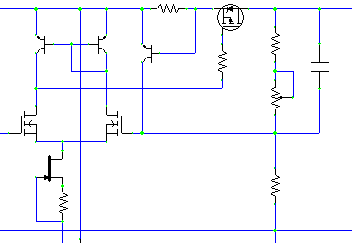

How could you incorporate a current limit into the PSU?

Could you explain, in detail, the function of C7, it appears to be passing output ripple straight back to LTP. I've seen this in other circuits. What specs determine it's effectiveness?
Why take the CCS to the opposite Vrail? Could they be returned to ground instead?
What is the RC time constant for c5? R1//R2 *C5 or other?
Have you simulated reduced values for C1&2? What happens?

I suppose the simplest method would be to place a small resistor in series with the source of the pass MOSFET, then sense the voltage across it with a transistor that shorts the top of R8 to the input. I've attached a schematic of how that would look. It would give just normal current limiting. I'm not familiar with how to implement foldback limiting, so I can't help you there.
AndrewT said:
...Could you explain, in detail, the function of C7, it appears to be passing output ripple straight back to LTP. I've seen this in other circuits. What specs determine it's effectiveness?
It does indeed feed ripple back into the LTP, into the inverting input, i.e. negative feedback. This reduces the AC gain, thus reducing the ripple. It needs to be large enough to start rolling off the gain well below the ripple frequency (100 or 120Hz). With the given component values it is ~7Hz. Larger values will improve ripple slightly, but more than 100n gives severely diminishing returns. Type of capacitor is not critical.
AndrewT said:
...What is the RC time constant for c5? R1//R2 *C5 or other?..
R1||R2 *C5 is 235ms, or a corner frequency of 4.3Hz. It is the voltage here that controls the output voltage, so obviously the higher the time constant the better the output ripple, but too high can cause it to take too long to turn on. These component values are the main contributors to overall performance.
AndrewT said:
...Have you simulated reduced values for C1&2?..
I have done sims with other values of reservoir capacitor. The ripple at the output is directly proportional to the ripple here. Smaller values give more ripple. More ripple means the dropout voltage must be set higher, which reduces efficiency. Choose whatever value gives the performance you want at the required output current.
AndrewT said:
...Why do I want current limit;- to avoid catastrophic failure downstream and also to slow charge downstream capacitance. I'm still thinking ClassA.
Ahhh. You don't need to worry about slow charging because capacitance multiplers give an inherently slow turn-on due to time constant R1||R2 *C5. You can easily have it take several seconds to approach full output voltage by increasing C5.

PS. I'm still using this very PSU, and have heard from a couple of people who have successfully built their own versions.

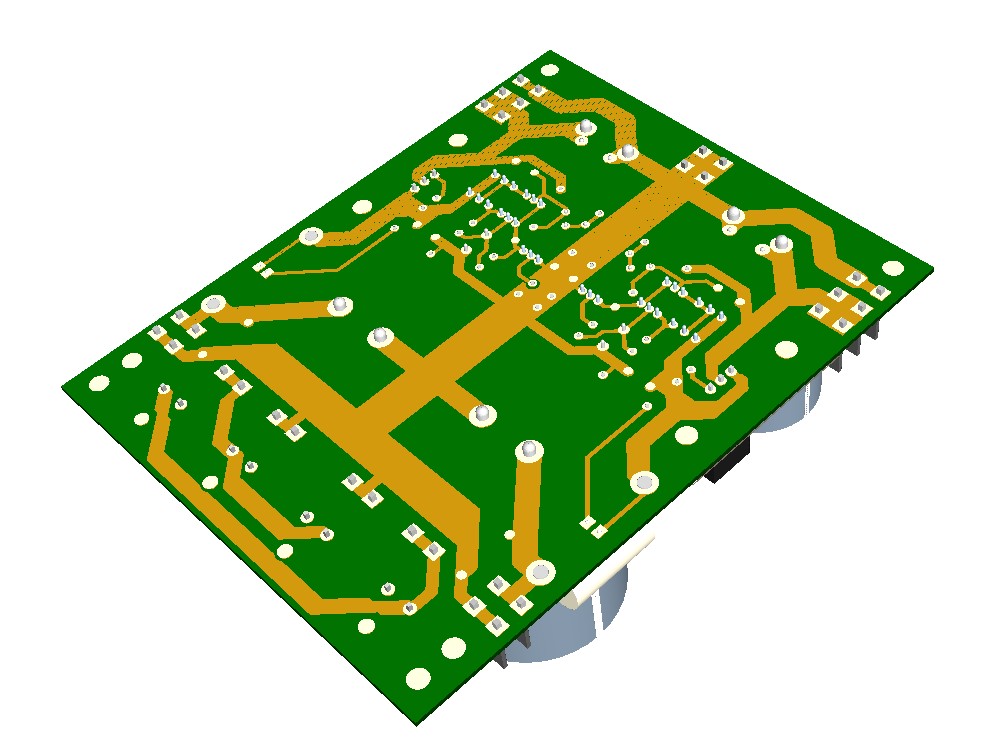

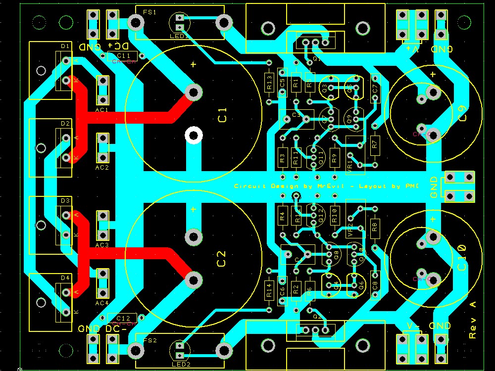

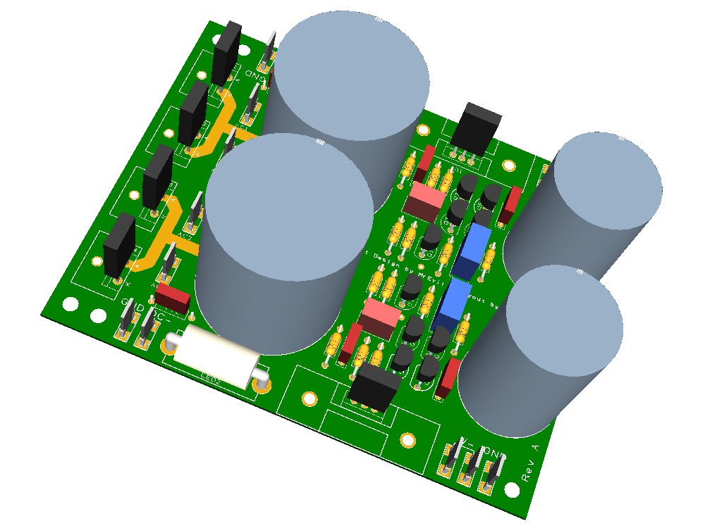

After much delay, my version of the Improved Capacitance Multiplier. I am basically at the prototype stage, and hope to have a working version in a couple days.
Layout is complete, pics below are 3D-renderings, and circuit boards are almost in my hands.
My goal is to adapt this design for use with my through-hole version of Shaan's simplified VSSA (aka PeeCeeBee),

The circuit is essentially the same one presented by MrEvil, only exception is that the jfets have been connected to ground, and not to the opposite rail, to make use of more commonly available parts.
My goals are to achieve controlled turn-on, low-ish dropout voltage, and moderate cost, with much lower noise and ripple than what can be expected from a pure rectifier/filter.

To continue discussion : in single layer way and to take care on short tracks from diode Gnd near DC+ and DC- could be share from AC2 and AC3 so that gnd tracks could be stopped and this point and than you have free space for diode to caps on same layer. Do you see an issue? Each Diode could be turn 90° so that you could shorten tracks from diode to diode...

Big thanks to both circuit designer and to pcb designer for this useful PSU! I am really surprised that this low dropout capacitance multiplier is not more used by diy-ers. It is versatile PSU, I intend to use it for all my diy amps up to 40V rails, not just for those that have lower PSRR.
I am not competent enough to comment pcb but if Marc has some idea how to make it single layer (for those builders who want to etch their own pcbs), why not?
