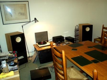

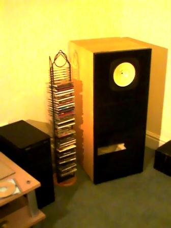

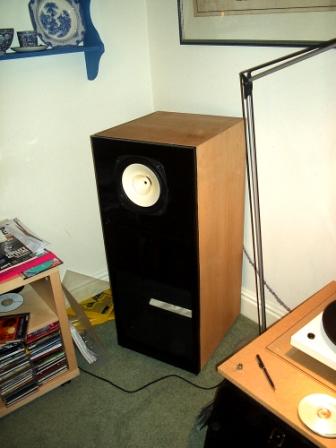

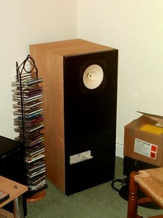

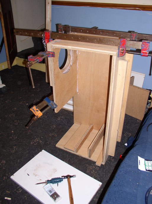

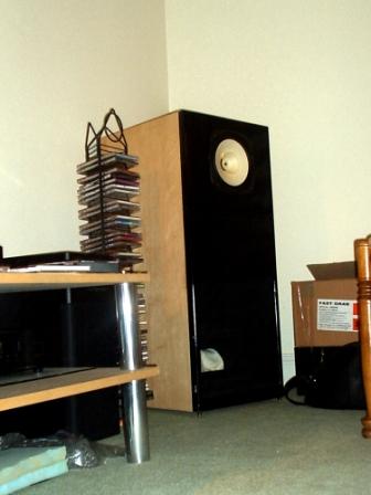

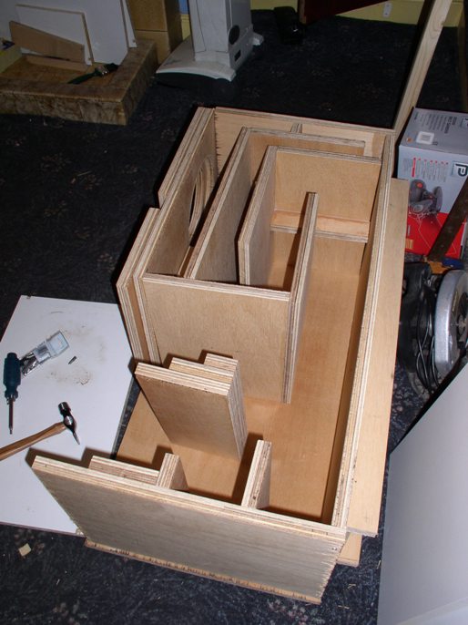

Here are some pics like i promised. There are some of the building of the horns and laying out. Sorry about the quality of the final pics, but unfortunately the usb lead to the camera is not around, so these picture have been taken on a P800 (phone). But they'll give u an idea... the fronts are actually quite shiny, and the sides/top are maple veneered.:eek:
Hope you like, I'll try and get some better ones done, however as I'm normally at uni and not inclined to take my beasts with me, it is tricky (and makes for an extra-long break in - boring):eek:

hey rich, seeing those pics brings back memories of last term hehehe :D
just for everyones info, we built the pair of horns during our spare time at uni, in the carpeted lounge of rich's rented house! using the circular saw and belt sander created rather a lot of dust . .
needless to say the estate agents wernt too impressed when they brought some prespective tenants round to view!
but now its time to build some speakers for me, luckily i have wooden floors in my place, slightly easier to clean up :)

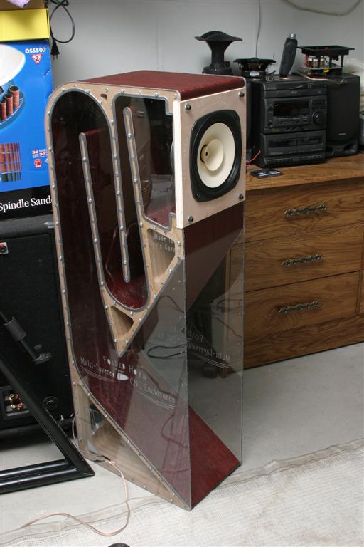

Layered Mauhorn

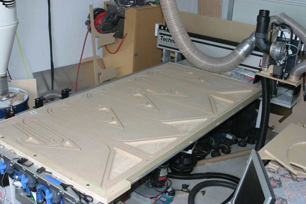

Not sure where to start, but I'm a new user; my first layred project was back in 2001 (see thread below). I have built a Mauhorn (courtesy of Andreas Mau). Looking at the design, it's very complex to deal with angle cuts; i'm not a good woodworker and very lazy, so i built one using layered mdf; 1st ever built horn.
- 13 layers of 3/4" mdf (3 sheets of 4'x8')
- 1/4" polycarbonate clear
- 1/4" dowel pins used throughout
- only bought 1 Fostex FE206e to test (about 100 hours now)
http://www.diyaudio.com/forums/showthread.php?s=&threadid=29133&perpage=10&pagenumber=3
