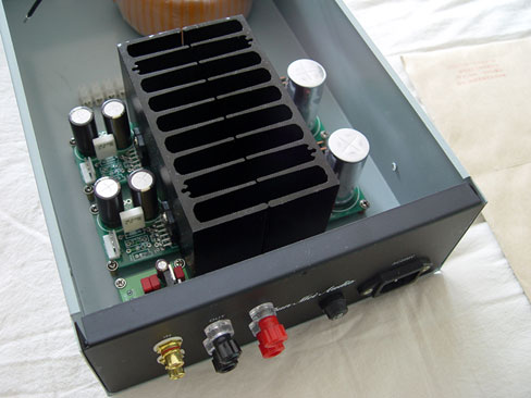

PCB based invert 3886 chipamp assembly and comments
this thread is build for talking about 3886inv gainclone and assembling.any suggestion is welcomed.
feel free to post your finished gc.

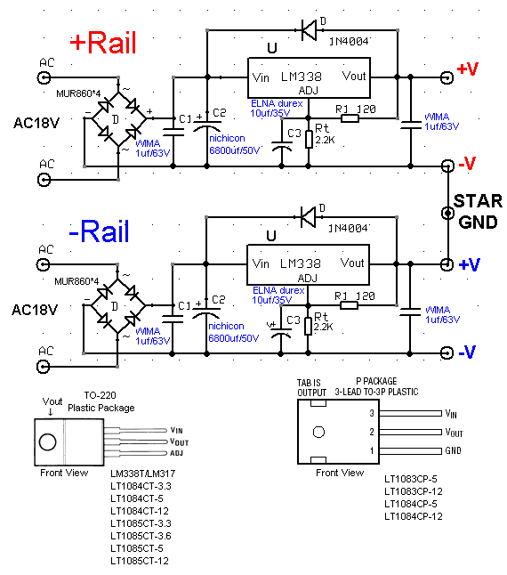

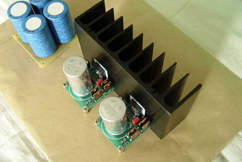

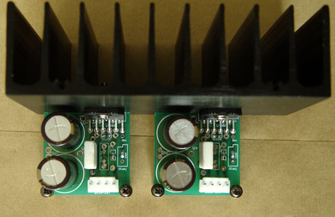

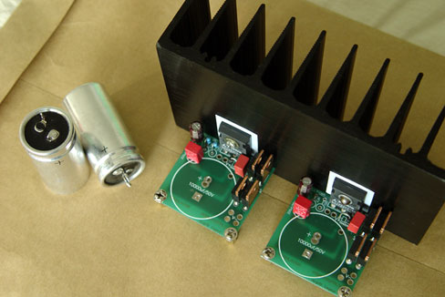

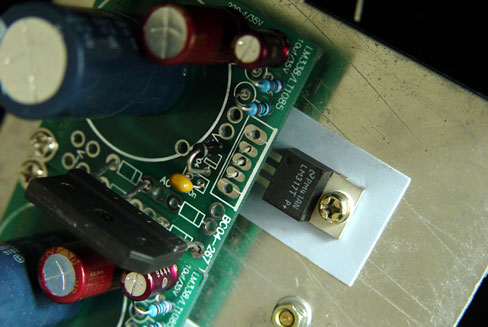

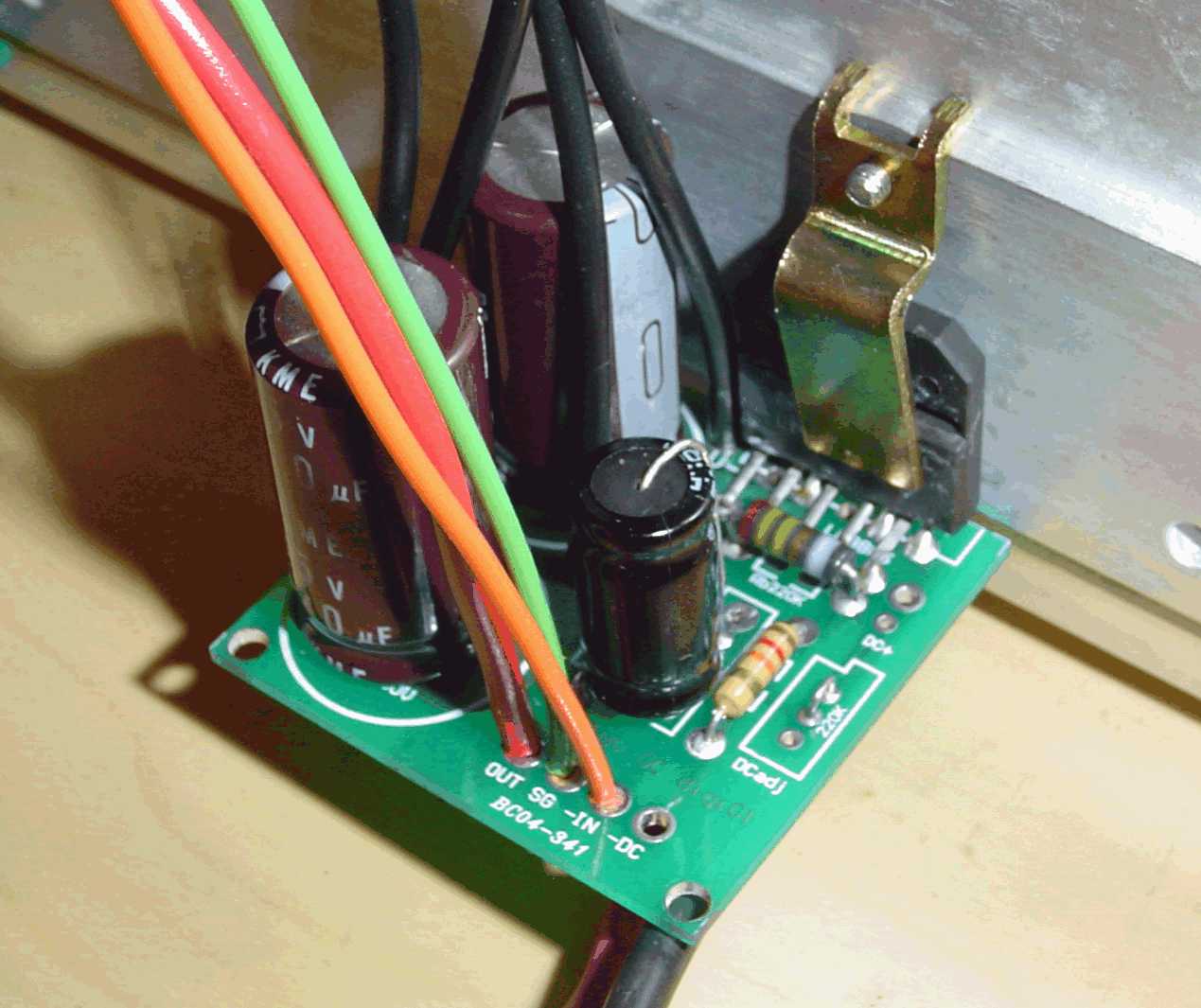

Pcb boards detail:
BLD driver
Regulaotr power supply
LM3886 INV AMP
The size of these three PCBs is totally the same,I like the layout style of tight & compact pattern.I think this way is mentality of designing of GAINCARD too.
I have not designed the unregulated power supply PCB.
If you want to assemble a PCB based unregulator igc,there are two very good unregulator pcb design:

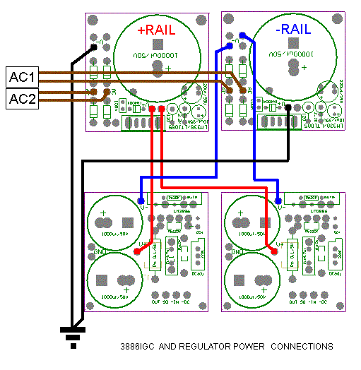

3886igc and regulator psu connections.
