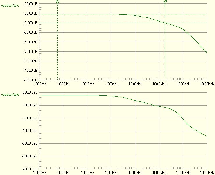

Hi, Charles.
I added a resistor in series with the integrator cap as you suggested, and now the simulated freq. response is better (no ringing) with no load, so it does improve things.
A last question before putting hands into the lab: how can I measure phase margin in the simulation? Sorry, but I have forgotten the details since I studied it, so if you want to remind me... can I measure it in open loop or is it necessary to introduce an excitation while maintaining it close-loop, as it is done when designing power supplies compensation?
What is a good phase margin figure for these kind of amps?
If you are so kind to explain the procedure I (and many others) would be very pleased.
Thanks!
Thanks!
Phase marging can be measured (i.e. simulated) by opening the NFB loop, grounding the input and feeding the signal into the feedback branch.
If you then simulate the frequency response and display it as phase and gain plot, you can look at the phase of the output signal at the unity-gain point (you can of course also measure it on the real amp that way). The phase-difference between the actual output signal and 180 degrees is the phase-marging. One is trying to have more than 90 degrees, but this would be in a perfect world, in reality it is usually less. Even many excellent-sounding linear amps out there have only about 45 degrees !!! But values between 60 and 90 degrees can be achieved with properly designed switching amps.

Wow, that's a fast response!
So, in an inverting setup like mine and many others, that means that I should break the loop by disconnecting the output from the feedback network, and then insert a test voltage in the feedback input (where before was the output), then ground the input, and compara the output with the test signal, that is?
Thanks!
Thanks!
Well, there's where my small mess comes: if the setup I have explained before is correct, the simulator gives a DC shift of +180 degrees (that's logical, it's inverting), and a DC gain of about 23dB.
Phase is going down until it is +77 degrees where the gain is 0dB.
What is the phase margin there?
My reasoning is this: Gain should be less than 0dB when phase is 0 degrees, so the output has gone round from +180 degrees to 0 degrees and hence it is in phase (oscillation occurs), so phase shift in my case is 77 degrees (in the simulation, of course ;-)
That's with 8 ohm load. The funny thing is that with 2 ohms load, the phase at 0dB is +105degs. That is too good. Am I doing something really bad?
Cheers.
Cheers.
Ouch !!
I made a mess myself. Since you already have 180 degrees by the inversion (that is actually necessary for NFB) it is the difference to 360 degrees (where oscillation would start to occur) that is relevant. So you have 77 degrees now which is quite cool !
If you load your filter more heavily two things happen: It is damped more and its phase-change gets less steep. Secondly the amplitude response is also less steep with an earlier rolloff. Both these things together may get you the effect you described. The unity-gain frequency will not be the same again however (from a first guess it is lower now), but who bothers as long as the overall outcome is a stable frequency response for all load conditions ?!
Regards
Charles

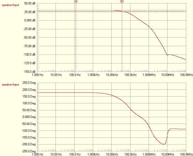

Well, if I reduce it to 4.7k then it crosses 0dB at 110KHz (4 ohm load), so ok.
Please, could you explain why did you wanted that condition? And how did you do the calculations? (if you are willing, of course ;-) I did some drawings and inserted the zero to lead phase shift and compensate the loop, but these subtle details escape to my (present) knowledge.
This figure is the speaker vs input freq. response at 4 ohms. It looks almost exactly the same for other loads. Do you think that the strange phase / gain change at about 10 MHz is worrying? I suppose it is due to the hf pole of the opamp.
Because a class-d amp is a discrete-time control system the loop gain has to be lower than unity at the Nyqvist frequency. IMHO the assumption that the Nyqvist frequency is half the carrier frequency (that many sources mention) is not completely valid, since we make two decisions per carrier cycle. As long as there is no drive signal the Nyqvist frequency (i.e. half the rate at which decisions are taken) is the same as the switching signal. With increasing modulation index, the two instances where decisions are taken, move closer together until they happen at the same time for 100% (or 0 % ) duty-cycle and is therefor reduced to the switching frequency. The only practical solution to expliot this fact is a self oscillating class-d amp (at least to my knowledge).
The only case when the values can be simply and elegantly determined mathematically is the case with an output filter with a Q of 0.5 but this is not very practical.
So the only values that were actually exactly determined is the integrator C and the parrallel capacitor for the feedback branch.

Edit: I wouldn't worry about the phase-change at 10 MHz.

Thanks!
I have implemented the changes in one of my prototypes (although the coil is 33uH and the cap is 1uF instead of 20uH+440n, so they are not identical to the simulations conditions).
The system works quite well, with very good transient (square wave) response (check the image: no overshoot and fast response). The gain and bandwidth are as expected also.
However, I have found slightly more distortion with a sine wave input than before, when the feedback was taken before the filter. Check the image.
On the other hand, the waveform doesn't degrade with high power levels. In fact, the image shows 72Vpp on 5 ohms, but it was the same with 70Vpp at 2.65ohm (230W rms). It is present in the whole audio band.
I think I should try with more feedback, perhaps reducing the 68k resistor (and recalculate the comp. capacitor in parallel accordingly). Do you have any suggestions?
Thanks!
