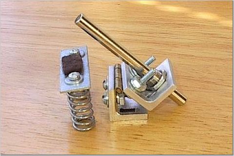

Attached you see an image of the spring loaded balance structure that is located behind the front panel.

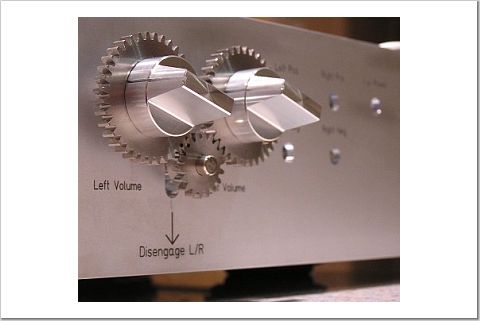

Originally the gears were going to on the inside, hidden. But I had no room, and they looked really nice so I put them on the outside.

How good are the gears in tracking the volume level with two different pots?
The gears work great! In the clockwise, increase volume direction, they are flawless, but they sometimes lose lock when you turn the volume down even though I doubled up the springs. You see that I used Alps stepped attenuators for the vol control (sometimes called blue velvet), and had I used a conductive plastic pots the gears would work a lot better in that they would mesh easier upon the spring release of the interlock. The Alps had 1% matching between decks (so I'm told) and were closer in value to the original circuit requirements, so I took them. So its still performance over ease of use. Also, round knobs would be tough to use so I selected aluminum knobs with a flat projection. They are Keystone (I think) from Mouser (definatley from Mouser).

How good are the gears?
Actually to correct the above quote:
I have discovered, though actually using this, that if you turn the volume up with the righthand vol knob, and turn the volume down with the lefthand vol knob, the gears work reliably in both directions. Turns out that the rotational forces cause the coupling gear, when operated in this manner, to want to go up (rather than down), and thus increases traction on the two gears above it. Its only when operated opposite to that described above that you can get the coupling gear to pop out, as it appears that the rotational forces sometimes overcome the upward spring force if used that way.
So this is actually a very workable system. As I am not a mech. engr. I didn't see this, but that's how it actually works.

I especially like the disengage feature that allows you to balance between the channels.
In addition to allowing for disengagement, the disengage feature allows for a wide tolerance of the left and right gear through holes; if the holes don't match as precisely as you want, you don't worry because you have a gear that is being forced upward until it mashes with the other 2 gears. So this gave me some comfort that the whole thing would work.

maybe you should have used an upper and a lower gear... that way it's loaded in either direction.
Yes, but I was in uncharted waters and just stuck to the basics? If I did it again I'd probably try it that way, though I would have to come up with a different way to disengage. Wonder if it would have a problem with binding?

Having used a very similiar gear set-up before (non audio related though) I have a couple of suggestions (for your next one ;) ). If you used gears with finer teeth it would allow for finer adjustment, unless you are using a stepped attenuator in which case the sweep of the steps would dictate pitch. Also, instead of using the rocker mechanism to engage/disingage, a push/pull would be simpler, more reliable and would fix your deflection problem.
