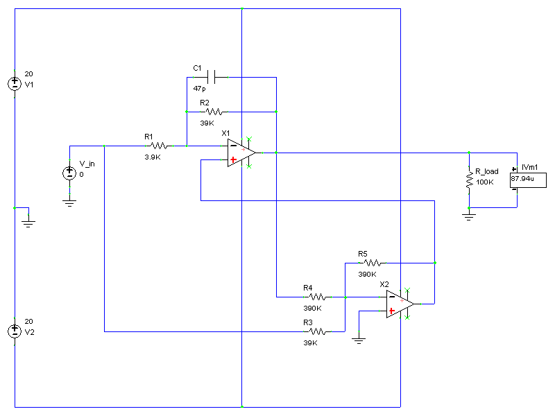

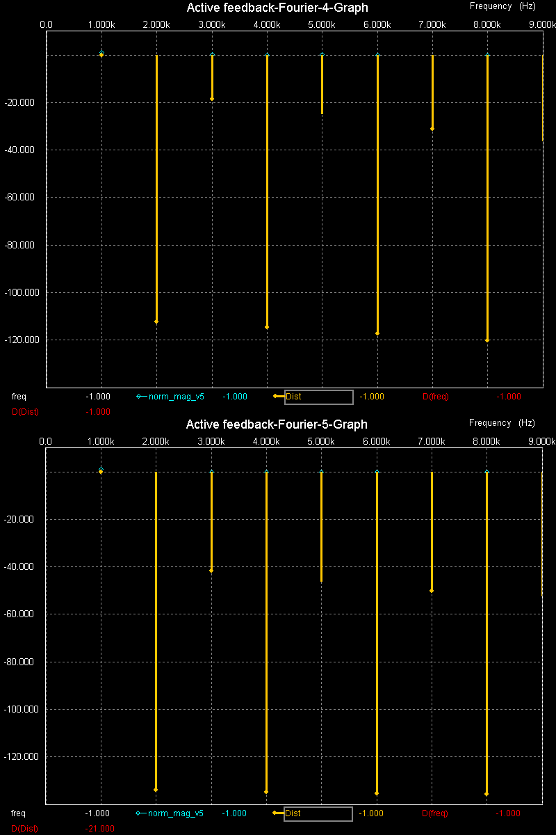

This idea is quite obvious so I'm sure someone has done it before, but I've never seen it mentioned anywhere so I'll post it anyway. I'm also not sure what it should be called; "active feedback" would be a fitting name, but searching on both this forum and Google reveals that name already being used to describe a variety of disparate techniques which are not this.
On to the heart of the matter: Negative feedback subtracts the output from the input, reducing nonlinearity and increasing bandwidth at the expense of gain. If instead of feeding back the output, the difference between the output and input is fed back, then linearity and bandwidth can be improved without sacrificing gain.
The attached schematic shows a practical implementation of the concept, with X1 being the main amplifier and X2 being the error amplifier. The error amplifier should be faster than the main amplifier to avoid ringing, or even instability. It should also be as linear as possible, which goes without saying, but it doesn't have to supply any current (ideally).

Distortion could theoretically be made arbitrarily low by increasing the gain of the error amplifier, but the main amplifier will need to be increasingly slower or the corrections of the error amplifier will cause ringing at frequencies where both the phase shift of the error amplifier is significant and the gain of the main amplifier still high enough. If my thinking is correct, then the reduction in distortion is ideally equal to the gain of the error amplifier (20dB as shown). Simulations show about this much improvement.

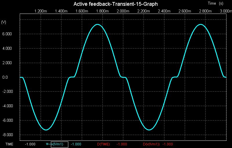

In reality I can't measure low distortion, so to see how it works in practice I added an antiparallel pair of diode in series with R1 to simulate massive odd harmonic distortion easily visible on an oscilloscope. The attached picture shows what this looks like before error correction.
More results in the next post...

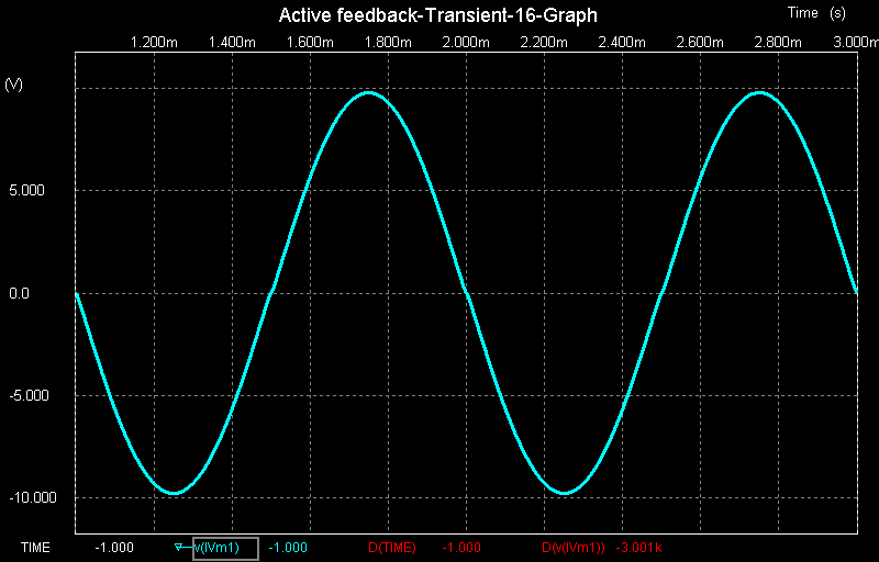

After error correction it looks like the picture attached to this post.
Doing a quick test on a breadboard with a dual op-amp shows that in reality it does exactly what the simulations say, surprise surprise. I haven't bothered showing anything about the increased bandwidth because I don't have a signal generator capable of testing an op-amp to the limit, but simulations show an improvement of similar magnitude to the distortion.

Mr Evil said:After error correction it looks like the picture attached to this post.
So has anyone made anything like this before, or read about it? Any drawbacks I haven't thought of (increased complexity and care needed for stability is all I can think of)?
I have seen your pictures. It works but I have to comment a little bit. The image (curve) that we can see after error correction is still highly distorted. The correction circuit must be able to remove cross-over distortion to that extent that it is invisible for the oscilloscope. Then you start with spectral analysis and will see your results.

It is similar, but not identical to the Hawksford error correction, explored elsewhere in this forum....
Yes it's still distorted. That's because it started of with an unholy amount of distortion in the first place. I've attached a fourier transform of the simulation results matching the two posted earlier. You can see that distortion is reduced by about 20dB for all harmonics, which is the gain of the error amp, as mentioned before.PMA said:I have seen your pictures. It works but I have to comment a little bit. The image (curve) that we can see after error correction is still highly distorted. The correction circuit must be able to remove cross-over distortion to that extent that it is invisible for the oscilloscope. Then you start with spectral analysis and will see your results.

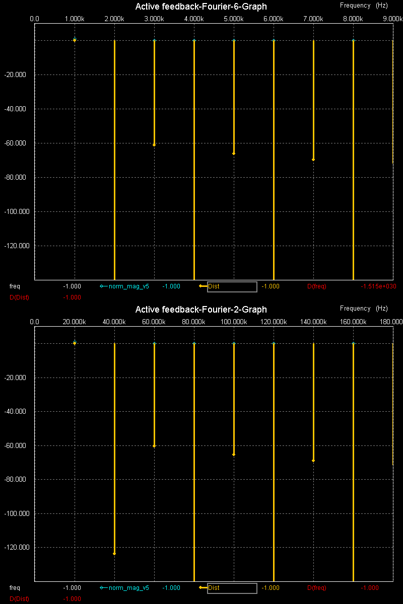

PMA got me thinking about the limits of the error correction, so I tried increasing the gain of the error amp to 40dB. Here's a fourier transform of those simulation results, showing a 40dB reduction in distortion. Now it's brought the distortion down to almost reasonable levels. Even harmonic distortion is off the scale, below -140dB.
The second graph is the same test performed at 20kHz. Here you can see the effect of the reduced bandwidth of the main amp (1/10th the bandwidth it was when the error amp only had a gain of 10). Odd harmonic distortion is still reduced by the same amount, but the effect on even harmonics is not as big anymore, with 2nd harmonic only just below -120dB, which is about the same as without error correction at all.

Mr Evil said:PMA got me thinking about the limits of the error correction, so I tried increasing the gain of the error amp to 40dB. Here's a fourier transform of those simulation results, showing a 40dB reduction in distortion.
Yes, this is what I would expect from the error correction. According to my experience it is possible to get 40 - 50 dB distortion reduction, and this is worthwhile. The combination of output stage error correction + NFB leads to excellent measured and sonic results. There are several advantages of an error correction: it reduces high harmonics caused by cross-over distortion, reduces and linearizes output impedance, extends bandwidth (reduces turn-on and turn-off spikes and phase shifts).
