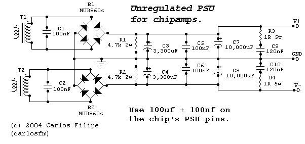

For a long time that I know this excellent article on power supplies:
http://www.tnt-audio.com/clinica/ssps1_e.html
Lately I've been thinking...
Why the hell don't these chips like high capacitance?
Why do they sound bad?
The reason is so simple that in the end I just wanna kick myself.
Bigger caps have higher inductance, and the amp will have lower damping factor at mid/high fequencies.
The thing is: these chips are really sensitive to this.
Go higher than 1500uf per rail/chip and you start noticing that the midband and treble magic goes away.
The more capacitance you add, the worse it sounds.
The solution is...
A snubber.
I've been testing tonight on my main system, with a new LM4780 amp that is in' in for 3 days on my bench, and it really works.
The original unregulated test PSU ended at C5/C6 on my schematic.
For some time ago - since I tested and use regulated PSUs - that I use 100uf on the chip's PSU pins (not 1,000~1,500uf), and as I reported off-topic on another thread, this works better even with unregulated PSU.
I tested adding to the PSU on the schematic 10,000uf (after C5/C6) and it sounded bad, as usual, but then I tested several snubber values until I settled with this.
It sounded better and better as I lowered the value of C9/C10, the resistors were always 1R.
This is preliminary, more and more tests can be made, but I don't feel that going to a much lower value for C9/C10 will improve things even further.
This is very old stuff, I'm surprized nobody ever tested this with chip amps, or had an explanation for these chips prefering low capacitance...
Here's the schematic, have fun.

Good work
As this is a real quantitative and qualitative claim, it would be good to actually have measurement data on it.
It's great that high capacitance finally sounds good for you.
Now why not make it reproducible for everyone?
What inductance is acceptble, what value is bad, which capacitor is the best with what snubber, etc.

Upupa Epops said:Carlos, little bit of theory : damping factor not depend only on impedance of PS , so your thinking is simplyfied.
Pavel, read my post more carefully, as I didn't talk about impedace at all.
I talked about the inductance of larger caps.

sek said:Good work
Sebastian, I have a broken scope in my basement and I didn't find the time to look at it yet.
The part that burned out is on a such a difficult place to get access that I have to dismantle the whole thing, including the screen.
As I said, this is a preliminary with an existing test PSU, it may not be a final schematic, or you may even have to tune it in every implementation.
What I say is that the effect of the snubber is quite amazing, and I've got to a value that works fine with this PSU/amp.
Everyone is welcome to test, measure, suggest, listen.
Who dares?

sek said:I'd like to see a systematic approach to wether the snubber can really be a cure in all situations.
One more thing:
It's so easy to test this that I hope you guys don't start asking for proofs no end.
The 10,000uf caps I added and also the snubbers are connected to the PSU with aligators.
The amp doesn't even have a case yet.
Neither does the PSU.
If this wasn't worth a try I would not even open this thread, even after testing it.
But it's worth a try.

Personally I would use 10x 1000uF instead of 1x 10000uF, connected using a sheet bus, and as close as practical to the chip supply pins.
Paralleling all those ESR's and ESL's really works in your favour, ripple current handling goes right up, and you get to choose from the ultra-low impedance types from Nichicon, Rubicon etc.

time to invest in a network analyzer --
most of the time the ESL of a capacitor is stated in nano-henries -- quite important for switching regulators where di/dt is quite large -- or if you are trying to couple an RF circuit since the inductance can swamp the capacitance.
i wonder whether the effects you experience with the LM338 regulator for your GC's isn't compensating for a transformer which has poor coupling, or is overheating -- i don't think that the series inductance of the filter caps is going to materially affect the power supply impedance at the kind of frequencies we are talking about.

jackinnj said:i wonder whether the effects you experience with the LM338 regulator for your GC's isn't compensating for a transformer which has poor coupling, or is overheating -- i don't think that the series inductance of the filter caps is going to materially affect the power supply impedance at the kind of frequencies we are talking about.
The first GC I made was with a 2x24V 384VA custom made toroid, unregulated PSU with MUR860s and 1,000uf per rail on each LM3875 board.
A typical GC, then.
This toroid didn't ever get hot, did never vibrate.
And it was quite a good trafo for two channels.
Unfortunately this amp, although good sounding, was not able to drive my speakers properly.
Bass was not tight, even at low volume.
I added 2x4,700uf caps on the PSU diodes and at first it seamed to sound better. At least bass was tighter.
Listening more carefully a week later, I found out that the amp was sounding like a cheap one. Low-level detail, midband, treble, "air", "ambience", soundstage, all went to the toilet.
I then made plenty of tests with capacitance and got my conclusions.
Then I made another modules with LM3886 and never looked back again to the LM3875.
But with the low capacitance unregulated PSU it was still not there as I wanted. There was more to be gained in driving ability, and I knew it.
Regulation did solve this problem in a way that I call my power amp a mini-Krell.
This test now with high-capacitance unregulated PSU is just because I felt that it could be made to work much better.
I don't say it's better than to regulate, in my oppinion it's not, but it will be enough to use with a much more variety of speakers tham the typical GC can cope with.
If one can't detect a difference for the worse in changing caps for bigger ones on the unregulated PSU with these chips, then there's a lack of transparency in the system that prevents it to be detected.
I don't ever take conclusions with my test speakers, the final and cruel test is always in my main system, where it gets all exposed.
Of course, I'm so used to it that I can detect any change for better or for worse.

Going left to right after the rectifiers: 10,000uF, 10,000uF, 100uF, 100nF, 560nF (or 580nF not sure).
moving_electron said:
I am having trouble making out the capacitor value in the figure 4 at the top of part Part 2. http://www.tnt-audio.com/clinica/ssps2_e.html
Does any body know what value the writer was recommending?
Carlosfm, I know you have tested and have a recommended value you like for chipamps, but I am curious as well about what the author of the article was recommending for (presumably) solid state amps.
Re: Re: The (high-cap.) unregulated PSU for chipamps
He suggests a starting point, but he also says it can be fine-tuned in every implementation between 220nf and 560nf.
Check the link I posted on post #4 of this thread, as that article is a little more detailed.
I started with 560nf, then 330nf, then 120nf and...
That's it for now.
It's in'-in, sounds good.
moving_electron said:Carlosfm, I know you have tested and have a recommended value you like for chipamps, but I am curious as well about what the author of the article was recommending for (presumably) solid state amps.
That's it for now.
