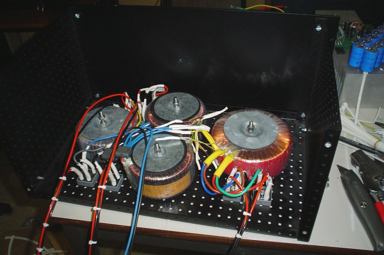

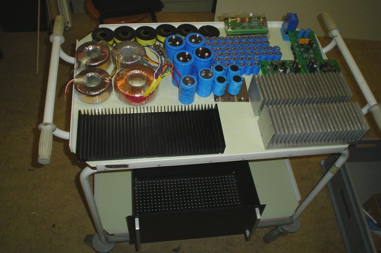

active system, first pictures
first pictures of my new active system
2x21w8555-01 with Aleph 5
12m4631g00 revelator with A3
d9505/990000 revelator with a3

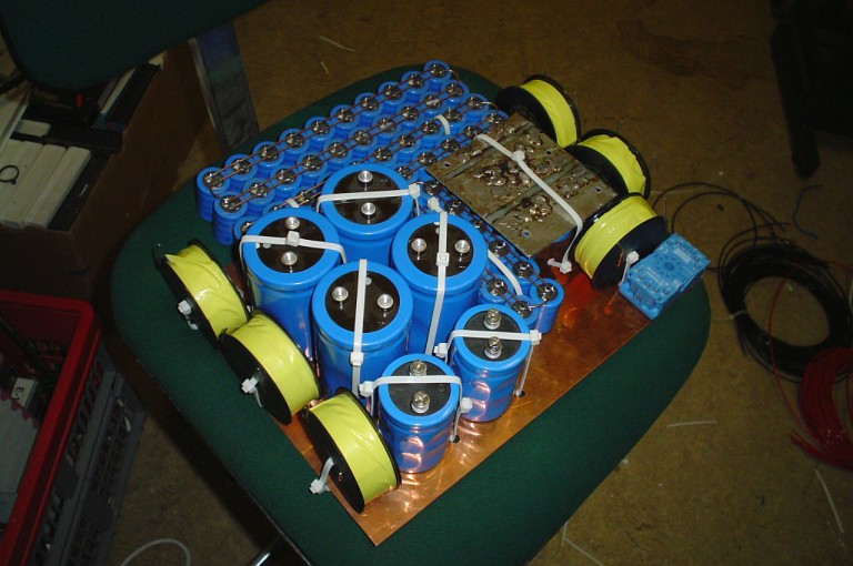

A5(mono) contains two seperate toroids (300VA) for each voltage rail, two bridges, 2x47000uF, 2.2mh(0,47R), 2x47000uF+12x4700uF
A3(mono) contains 470VA, 2 bridges,2x47000uF, 2.2mH, 20x4700uF
A3(mono) contains 300VA, 2 bridges, 4x22000uF, 2.2mH, 20x4700uF

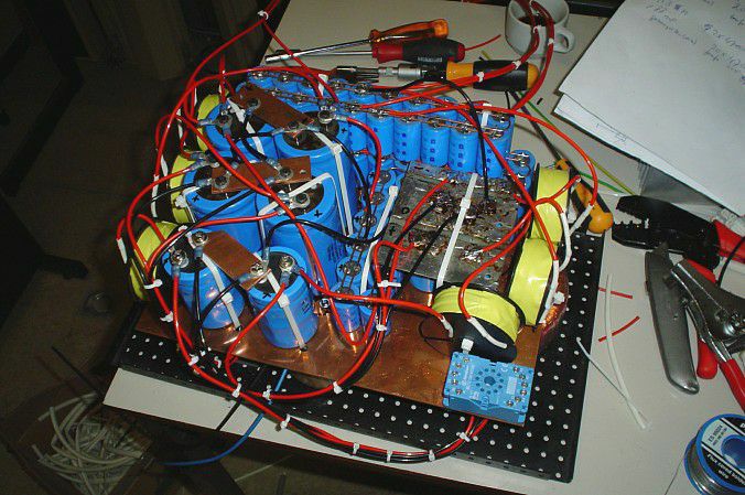

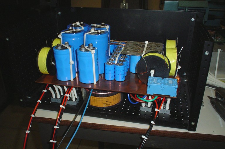

total uF (stereo) will be 244400+188000+182000=614400x2=1.228.800uF!! So special care should be taken with switching on. The caps will be loaded with large 100R and after 1 minute full power will kick in. (with a programmeble timerelais)
Here are the first pictures

today installed 3 Thermistors (5Ohm ntc)+10 ohm resistor to repress inrush current. After 40 sec's they will be bridged.
So far so good! Then installed 1 Aleph 5 en that worked as well!
