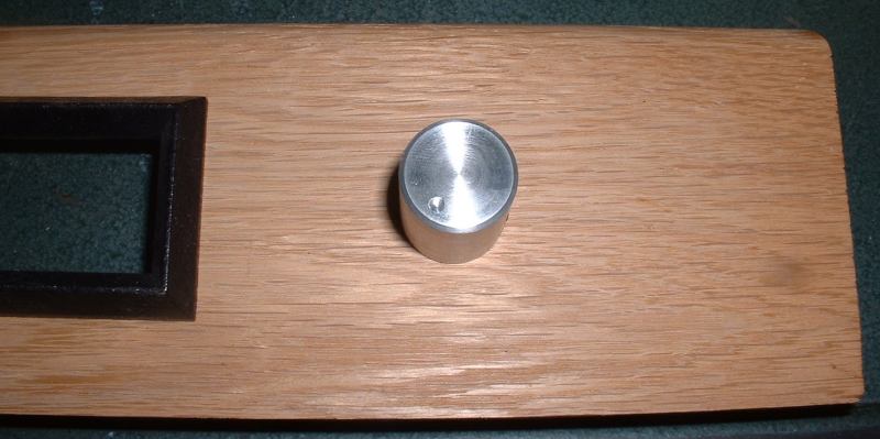

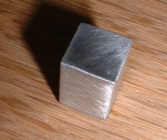

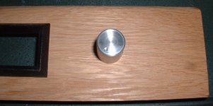

DIY Volume knob and Function buttons made of aluminium

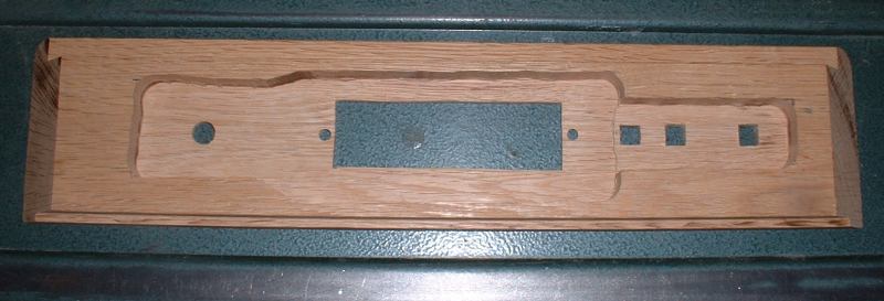

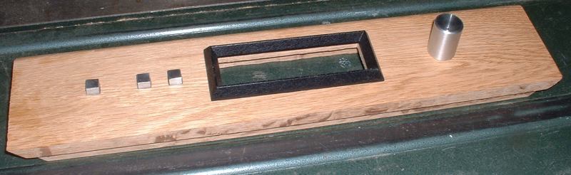

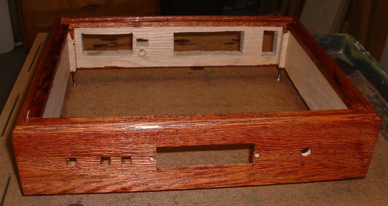

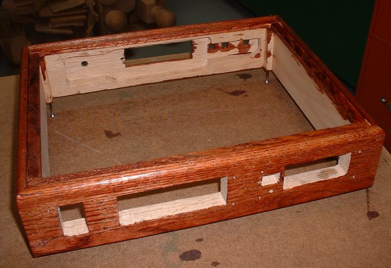

First, the wood frame
The frame is made of oak. I cutted all the holes first. Used a router to cut in the front panel to let place for the LCD display, Switches PCB and motorized pot. Four nice coats of Red Mahogany Red MinWax Vernish/Taint covering. Here it is, not too bad.

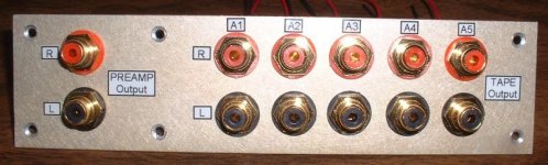

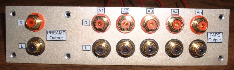

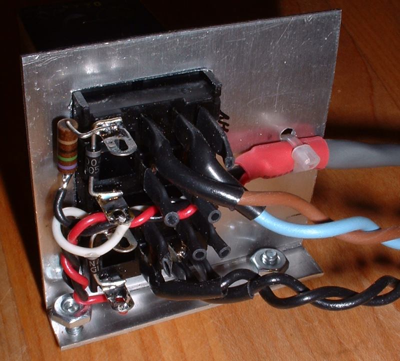

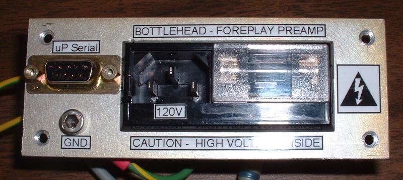

The other plate is what I called the AC Outlet plate. The IEC noise filter with integrated fuse socket is mounte there. It contains also the Processor serial port and the Frame GND screw. This screw is connected to the AC safety gnd. Two wires go from there and connect to the top and Bottom steel plates for safety.
Then it goes to an RC Gnd loop killer 10R,3W and 0.1uF, 400V, X2-Type cap.
Then the other point of the RC goes to the preamp star GND point. These GND are not directly conencted to the frame (safety gnd).

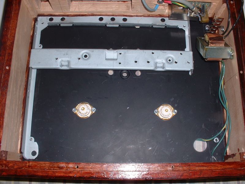

Inside, i needed to hold the tube supplies caps in place. I also need to find a place for the relay assy. These relays turn on the filament power, then the HV in sequence under processor control.
I also wanted to keep the AC on the right (view from the bottom) and near the AC outlet. I'll keep the audio on the left. The control will be on the right near the front.
Instead on drilling a lot of holes in the top plate, which is least nice, I salvaged a steel sub frame from an old computer monitor. I cut the frame according to my need and install it using just 3 screws on the top. Then I'll use this frame to mount the reast of the big stuff. This frame is also quite rigid.

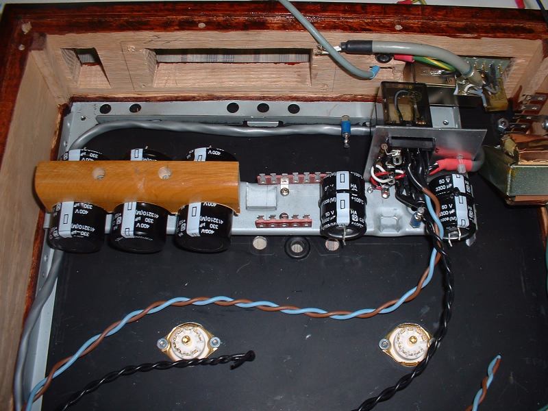

Here is the sub-frame with everything mounted on it. You can see the 3 bigs caps on the left used by the HV Pi-Filter. A nice wood backet hold them firmly in place and kill vibration. In the center, just over where the Tube Supply transfo will be located are the soldering bars for the transfo wire and the discrete fast-recovery diode bridge. I'll use the MUR860, 600V, 8A diodes.
Then on the right, you can see the relays assy mounted vertically and the two caps used for the filament supply. On the back, you see a small blue isolated stand-off. That will be the star gnd.
Then the subframe was all cover with vibration absorbing sheet.

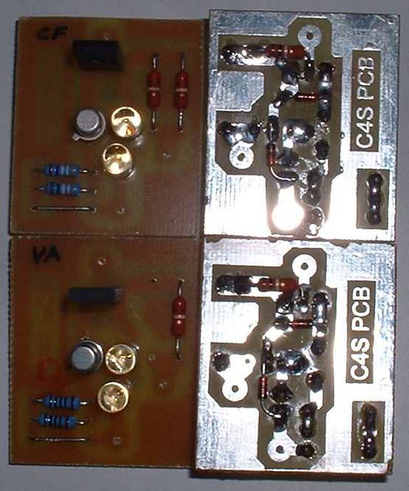

Here my own version of the Camille Cascode Constant Current Source PCB that I will use to biais the tubes. I combined the informations on these two sites to get the circuit working :D,
See:
A good tutorial on how to assemble the C4S Foreplay option:
http://home.att.net/~joemacjr/diyproject/anticipation_tutorial.html
and this excellent discussion on the C4S protections:
http://www.siteswithstyle.com/VoltSecond/C4S_extended_volts_and_amps/C4S_extended_volt_and_amps.html
Take note that the original Anticipation circuit is a BottleHead Desing and their property. Since I never saw their PCB, I cannot comment on how it to compare mine. :smash:
