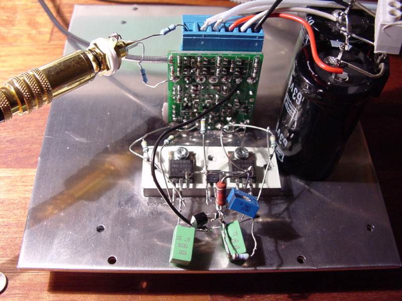

I'm not going to post any schematics here, because of diyaudio's copyright rules. (I might get into trouble just from using my own design).
However a few pictures are no problems, first the birdsnest of the small 50W N-channel amplifier. It uses two IRF640N devices, but even smaller ones will do fine. You can almost see how i have made the output circuit in this picture, if you look closely. The green PCB in the back is a small folded cascode voltage amplifier, and power plug, to unplug everything in case of problems, when experimenting. :) The voltage amplifier also features soft clipping and a total rail loss with N-ch devices of around 4 V (similar to a bipolar output device with 0.22 Ohms emitter resistors).
Just by replacing the IRF640N's to something bigger you can increase outut power to much higher levels. The rest of the circuit is calculated for +/-100 Volts supply, and 5nF capacitive load, so around 500 Watts in 8 Ohms should be no problem.

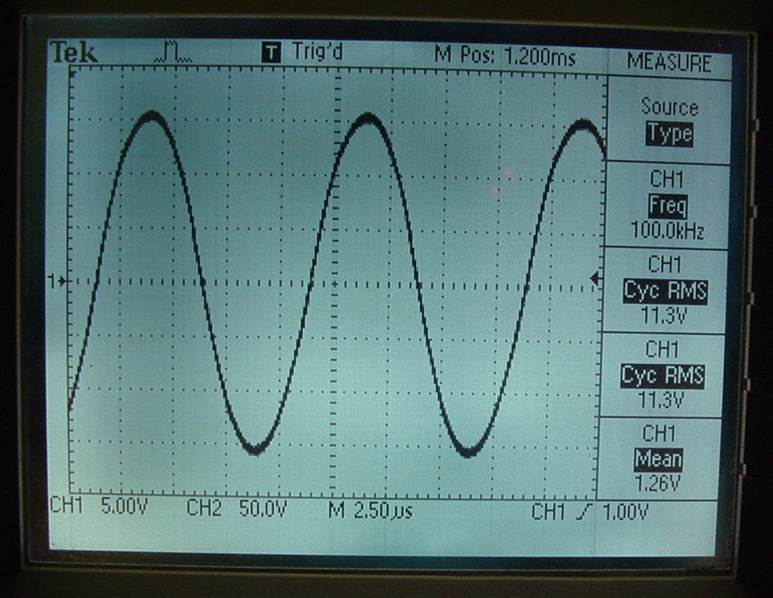

Below you can see the output waveform. Note the frequency, 100 kHz is the highest this sinewave generator will go. But the amplitude is not even 1dB down compared to 1 kHz.
If you notice a small ripple on the top of the sine wave, it is due to the feedback being shifted to before the output circuit over 50 kHz. This is to maintain stability in high capacitive loads, without sacrificing bandwidth. See the ULCA thread for further details on that one.
Output power here is just 16W (the transformer is a 30VA, and it's sweating!) :D
