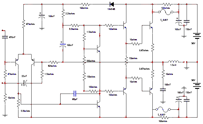

Thank you all friends, have your seat belts attached?
Hello Grim..... like you (Grrrrrrrr!)...not dislike, we are brothers...now!, not yesterday!
The amplifier is the most basic form that can make good sound, there are around 7 modifications that increase a lot the sound, and not only parts, but also the material used to build the mentioned part.
This way will work good, i tested few hours ago...I could perceive differences.
Diferential transistors are matched 2N5401
Bias multiplier can use BD139
Voltage amplifier cannot inform, a lot of them works there
Drivers are 2SC4793 and 2SA1837
Output are 2SC5200 and 2SA1943
VBE multiplier transistor can be mounted over 2SC5200
Bias is 50 mA, and re-adjust again some minutes after first adjustment
100 Ohms resistor connected to Voltage Amplifier transistor is a trimpot, small variable potentiometer.
If you do not reach the bias current, change R12 value
Voltage is plus and minus 36 Volts and power will be 55 Watts RMS over 8 ohms with 0.65 Volts RMS input
My thanks to Hugh that decided to show this amplifier to us, try it first, and them can here to tell us some evaluation.
regards,
Carlos

Hi Carlos,
Your reply is strongly reminiscent of Groman(swe) alias Halojoy. No offence meant!
I even had the strong feeling he was back!. But of course this is all too simple and not good. You are living in Brazil and Carl Groman is up in the north of Sweden.

My thanks to Carlos, who posted this indicative AKSA circuit with my full support.
I decided to publish an indicative AKSA circuit for the interest of members of this forum. I make it clear, however, that this is NOT the full AKSA circuit, which is quite a bit different. This is similar to the AKSA, and in fact very like Rod Elliott's P3A, for those of you who might know that circuit.
There are numerous detail changes, and a pcb layout, and some pretty careful component choice, which distinguish Carlos' circuit from the real thing.
Pavel's criticism is entirely correct. The 10R ground lift resistor is very important. A couple of power diodes across this resistor solves the problem, however.
Now, a few words about the AKSA approach/topology.
This is a conventional Bailey-inspired PP Class AB fully complementary SS power amplifier. This topology is widely used because it works, and incidentally has low parts count. With great care in operating point, layout and parts selection it can be made to sound very good indeed, but it has taken years to figure out all the details. For those who want to retrace the steps in the journey, here is the start point. For those interested in the destination, the choice is more commercial, but the work is now complete at affordable cost for the kit builder.
A word about chip amps. I have heard a few in recent times, and some of them are very, very good, entirely satisfying. However, there is still a place in the Sun for the discrete amplifier circuit, because side by side comparison reveals they do different things. For starters, the discretes have more power. And one should never forget that in terms of bang for the buck, nothing is superior to a chip amplifier.
Hugh
Yes, Hugh. I you had not noticed, I would have done it. The reason is that the possible difference in ground potential of 2 earthed devices may simply burn 10 Ohm/0.6W resistor.
I greatly appreciate your comment.
